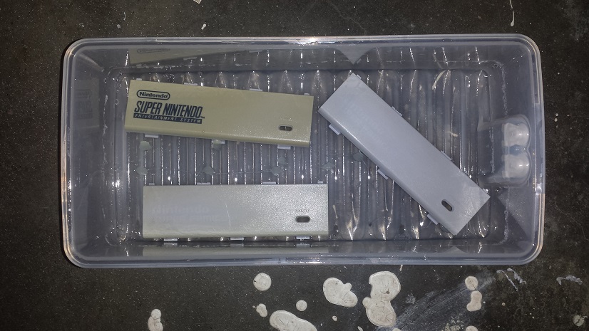

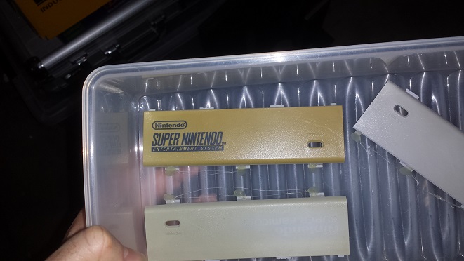

    this thread has me interested about the retro bright process, and if oxyclean alone will have any results. so did a little test, and placed a few pieces in the Queensland Australian sunlight.
    The not so yellowed pieces have already been in the sun for 1 day. nothing but water and oxyclean
    and after 1 day in the sun. the bottom piece was floating on the surface, so probably didn't receive the full benefit.

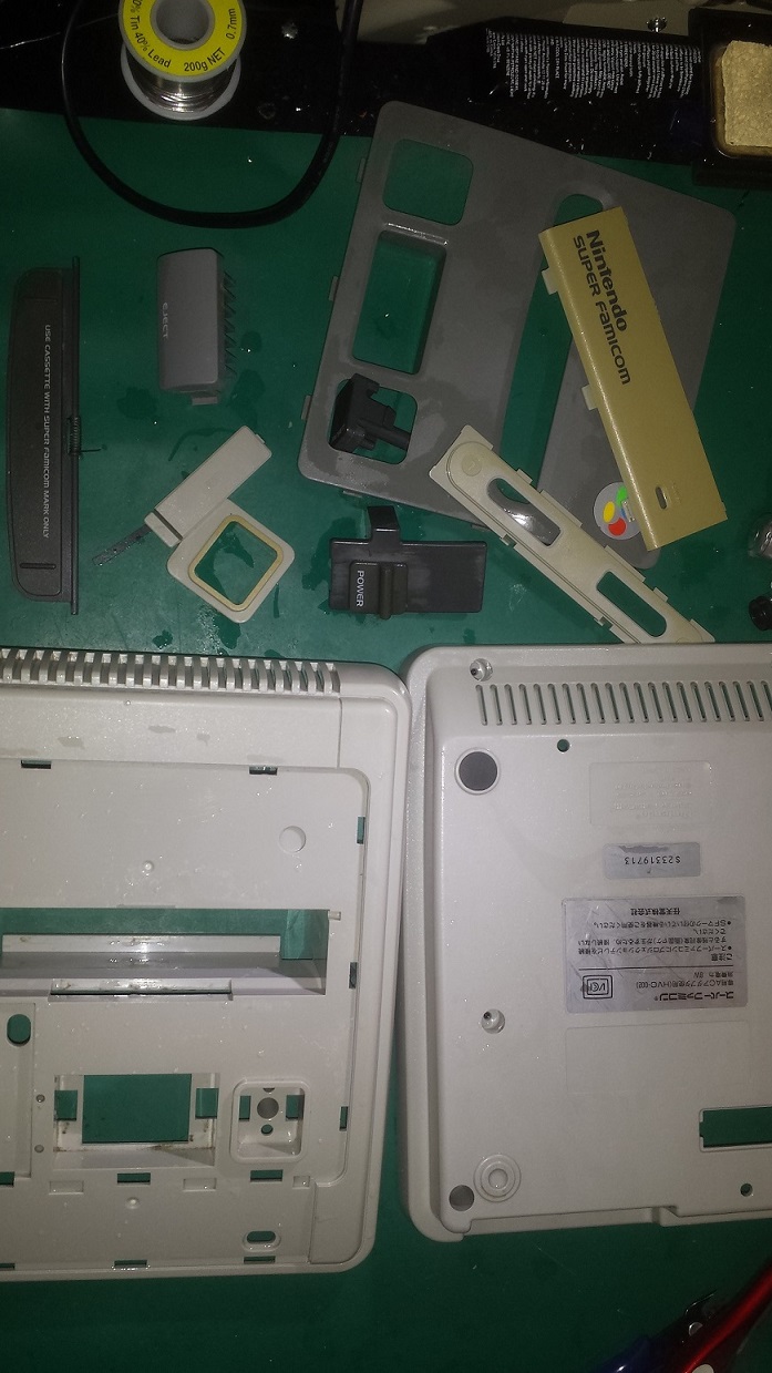

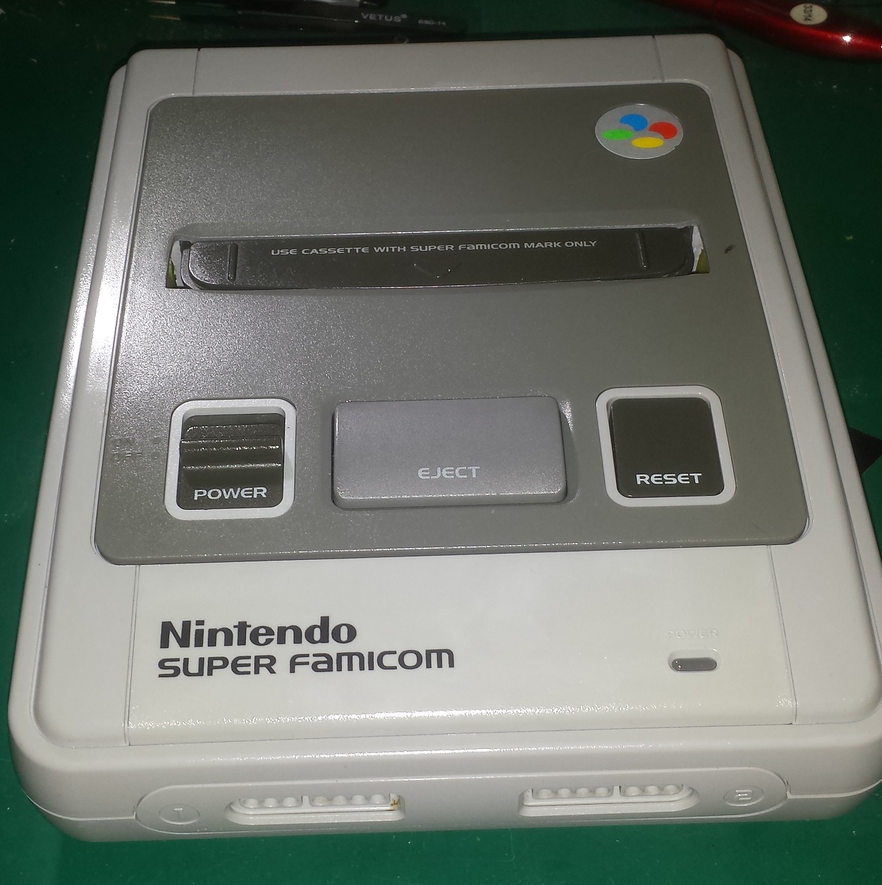

    so on the weekend i sold a super famicom modded with supercic, the console was yellowed. So excited about my recent creme developer 40 purchase, i offered to de yellow it for free.
    The shell was placed in a large plastic container with the lid on.
    This product can be purchased at https://www.priceline.com.au/search/?q=Innovative Creme Developer - 40 Vol 1 L
    below are the results

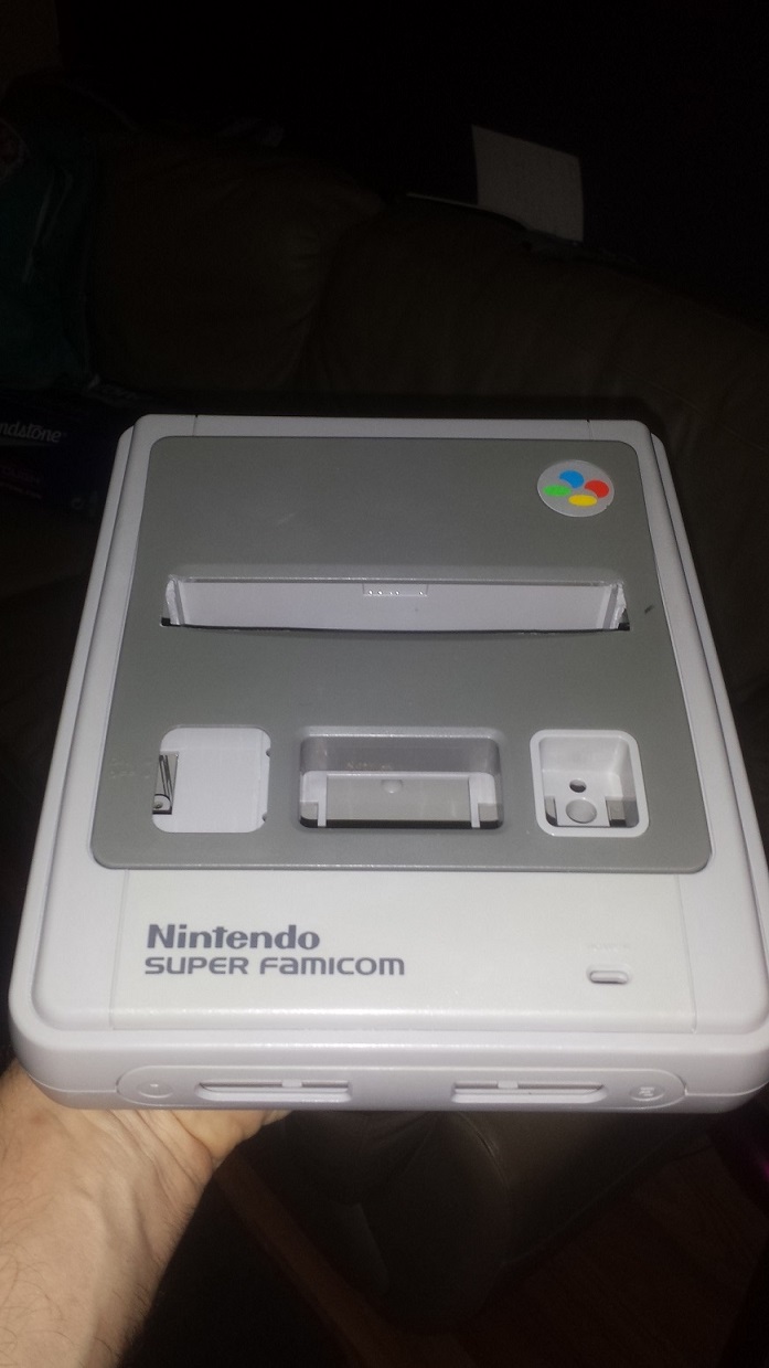

    and the results after 1 day in sun. not bad, but it was a very sunny day!
    still need to complete the cartridge slot widening.

    put the super famicom plate in the sun for another day. seems good enough now. next time i will try putting smaller pieces in a zip lock bag.
