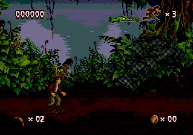

    Yes the dithering doesn't look good, but it's still a part of the picture. I'd take dithering any day over composite. Your Pitfall comparison shows the one benefit of composite, that the picture is so blurry that the checkerboard pattern on the leaves blend together and gives the illusion of a different color. I realize that many 16bit games were designed with composite in mind, and used dithering to create transparencies and more shades of colors. Considering that 99.9% of all Mega Drive owners back in the day used RF or composite I think the graphics artists were right to use dithering in their games.
    However your second image also shows everything that's wrong with composite. The extreme blurriness, the washed out colors and the rainbow effect on the white numbers.
    Some might argue that the waterfalls in Sonic 1 or the car shadow in Sega Rally looks wrong in RGB since theres no blurriness to blend the dithering together to give that transparency effect. In my opinion correct colors and sharpness drastically outweighs that one "possitive feature" of composite :)
