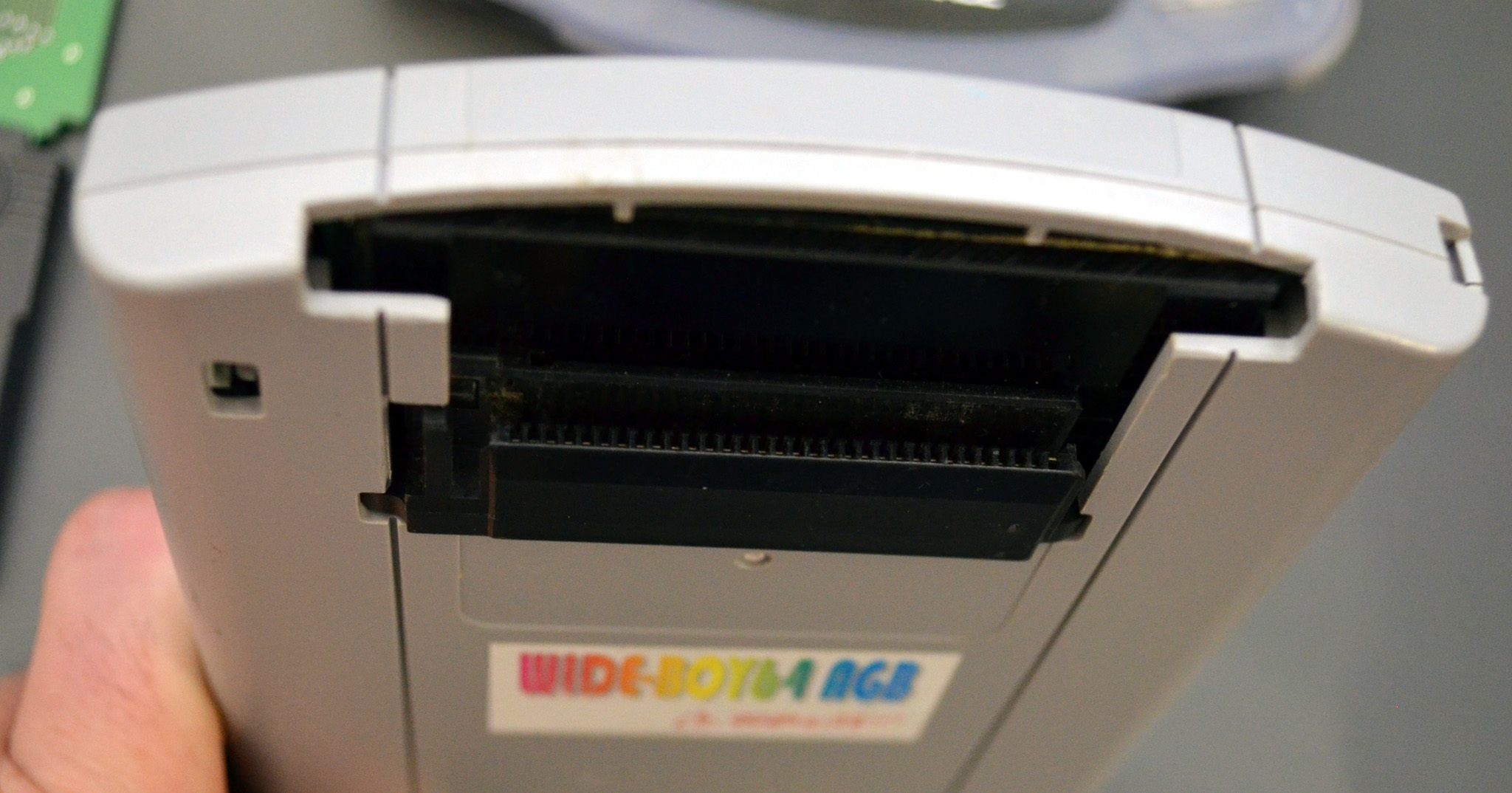

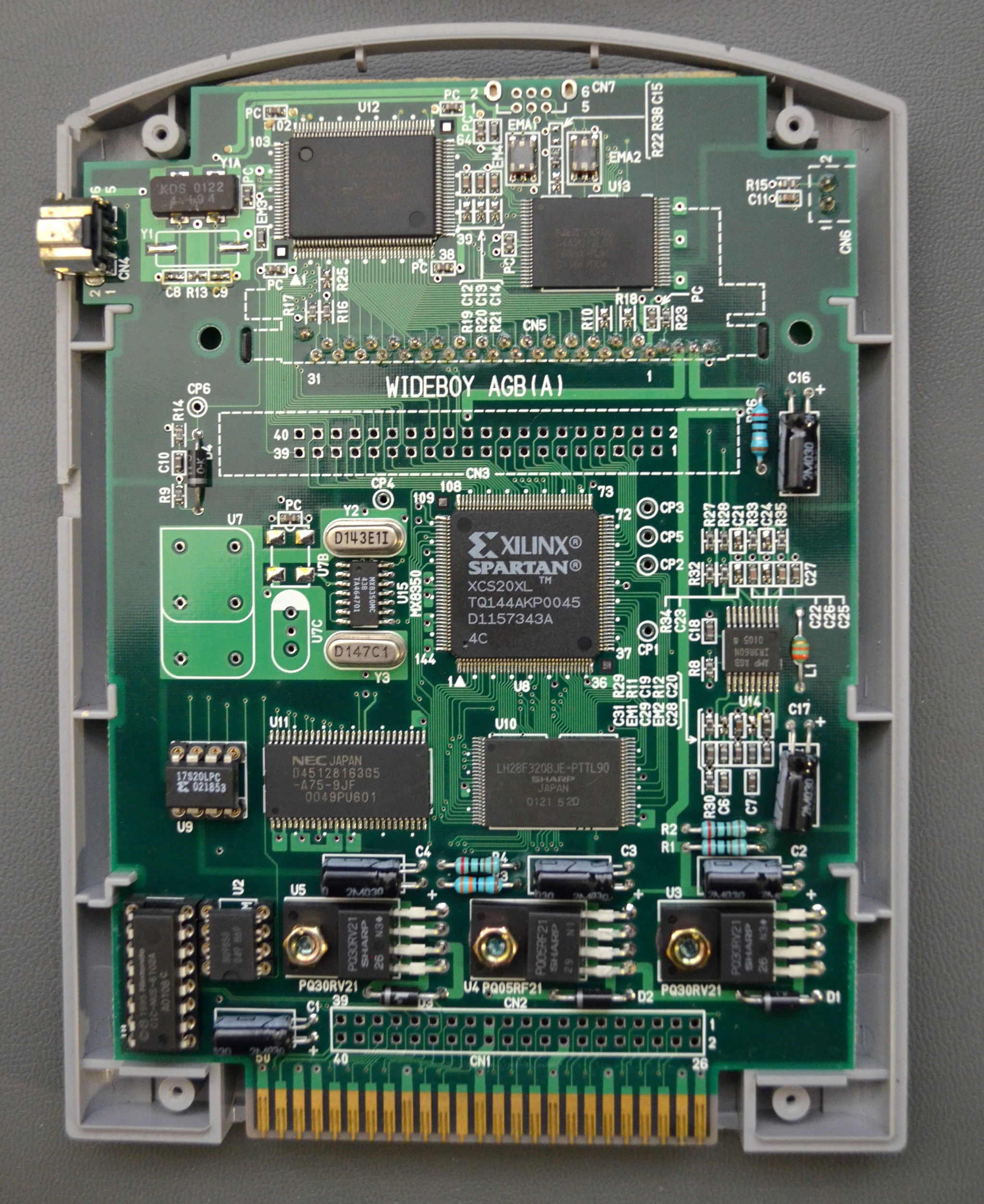

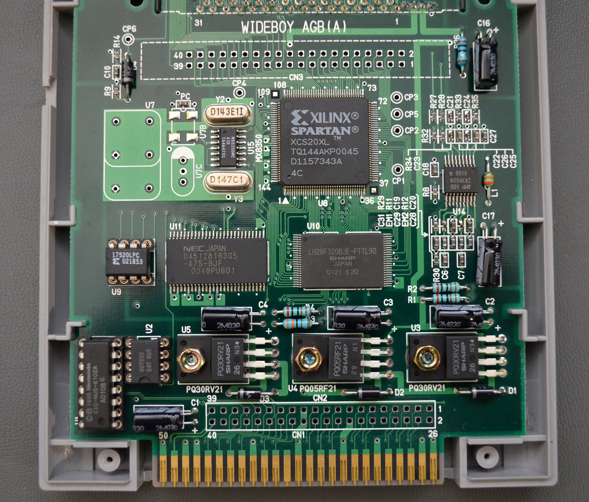

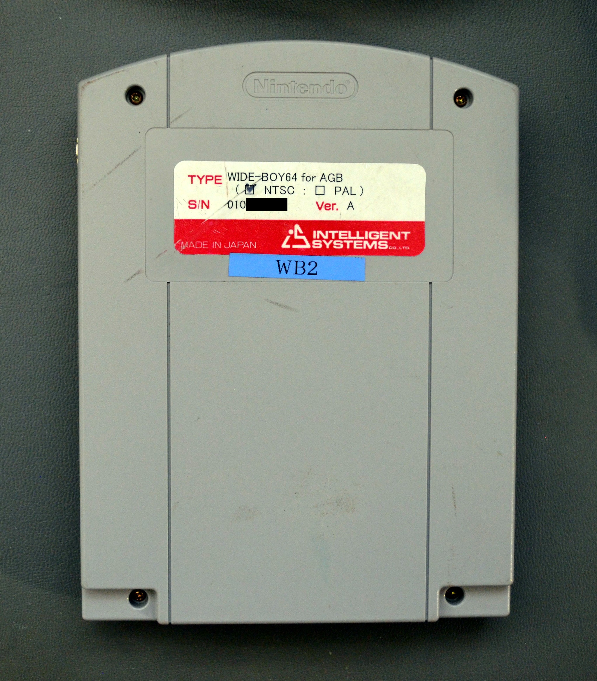

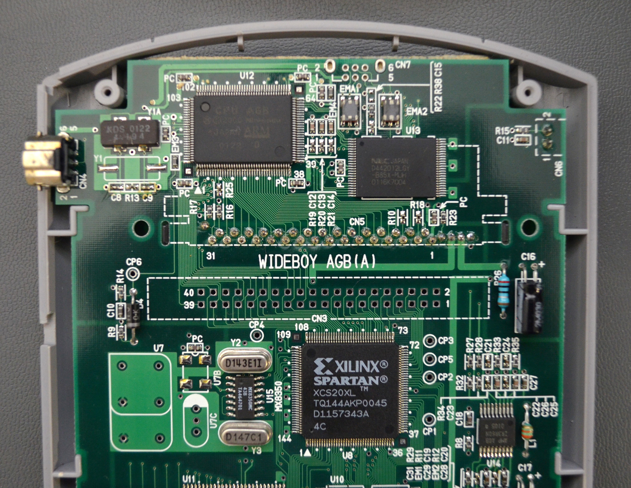

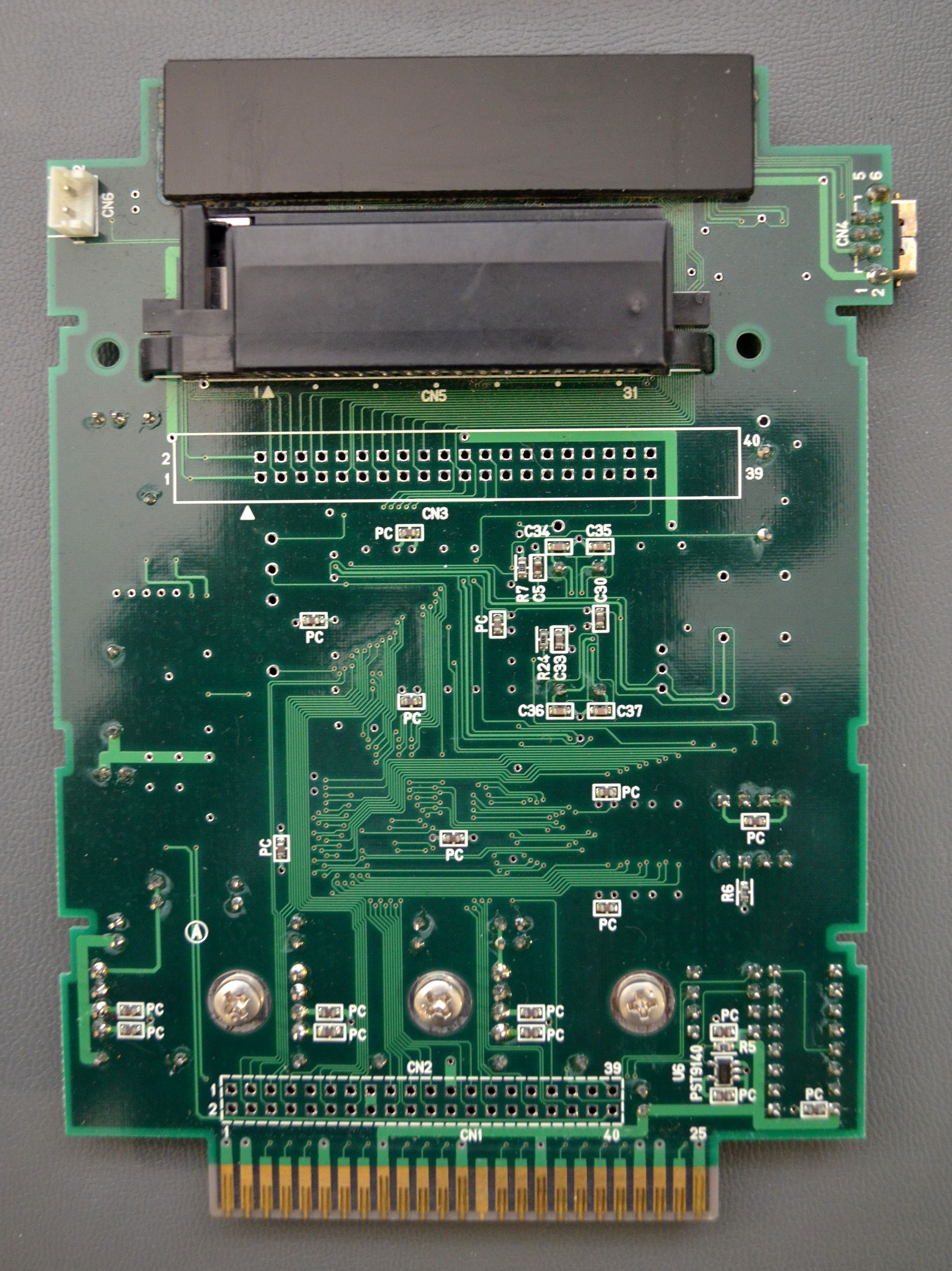

    Hi Folks,

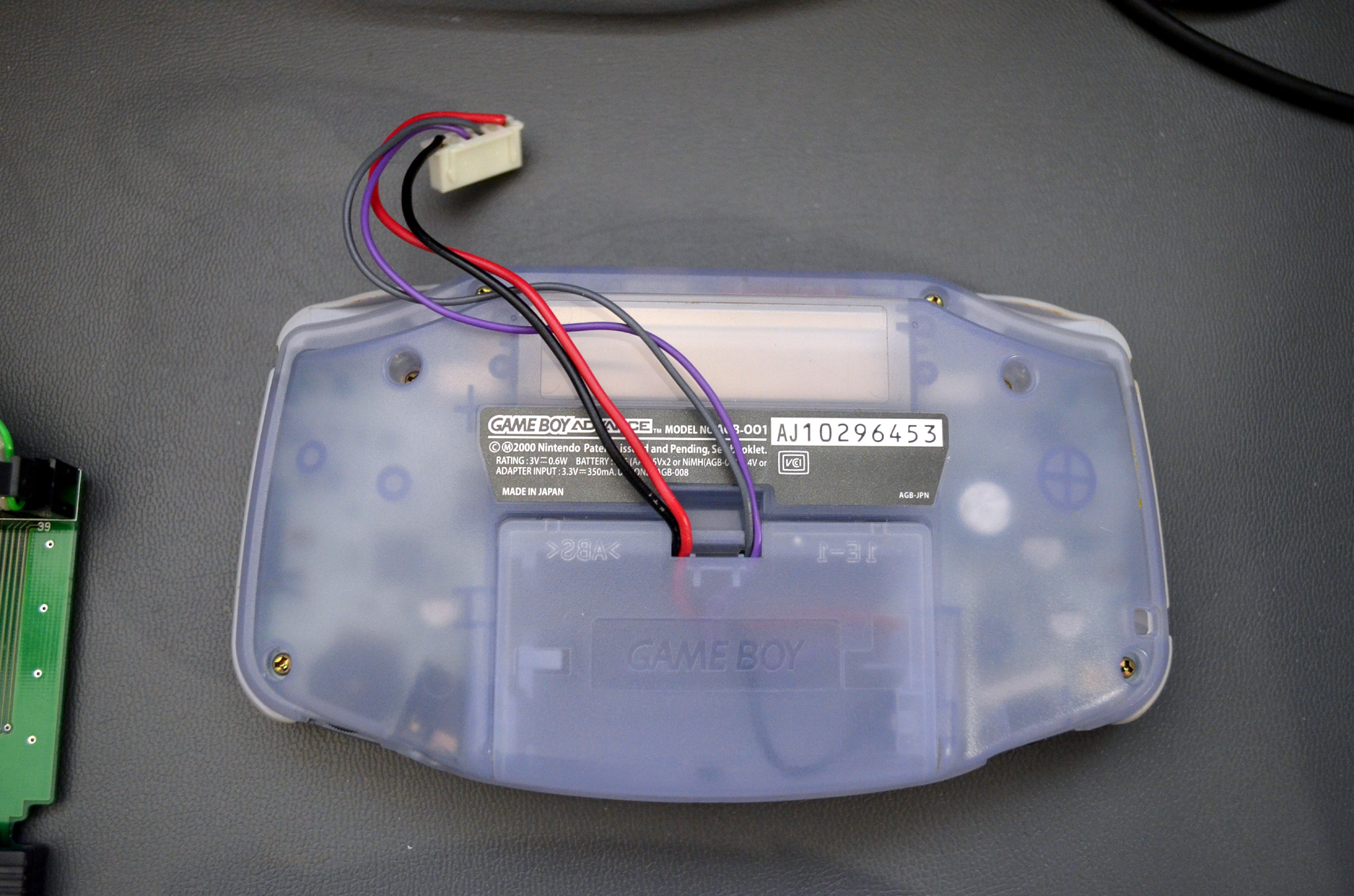

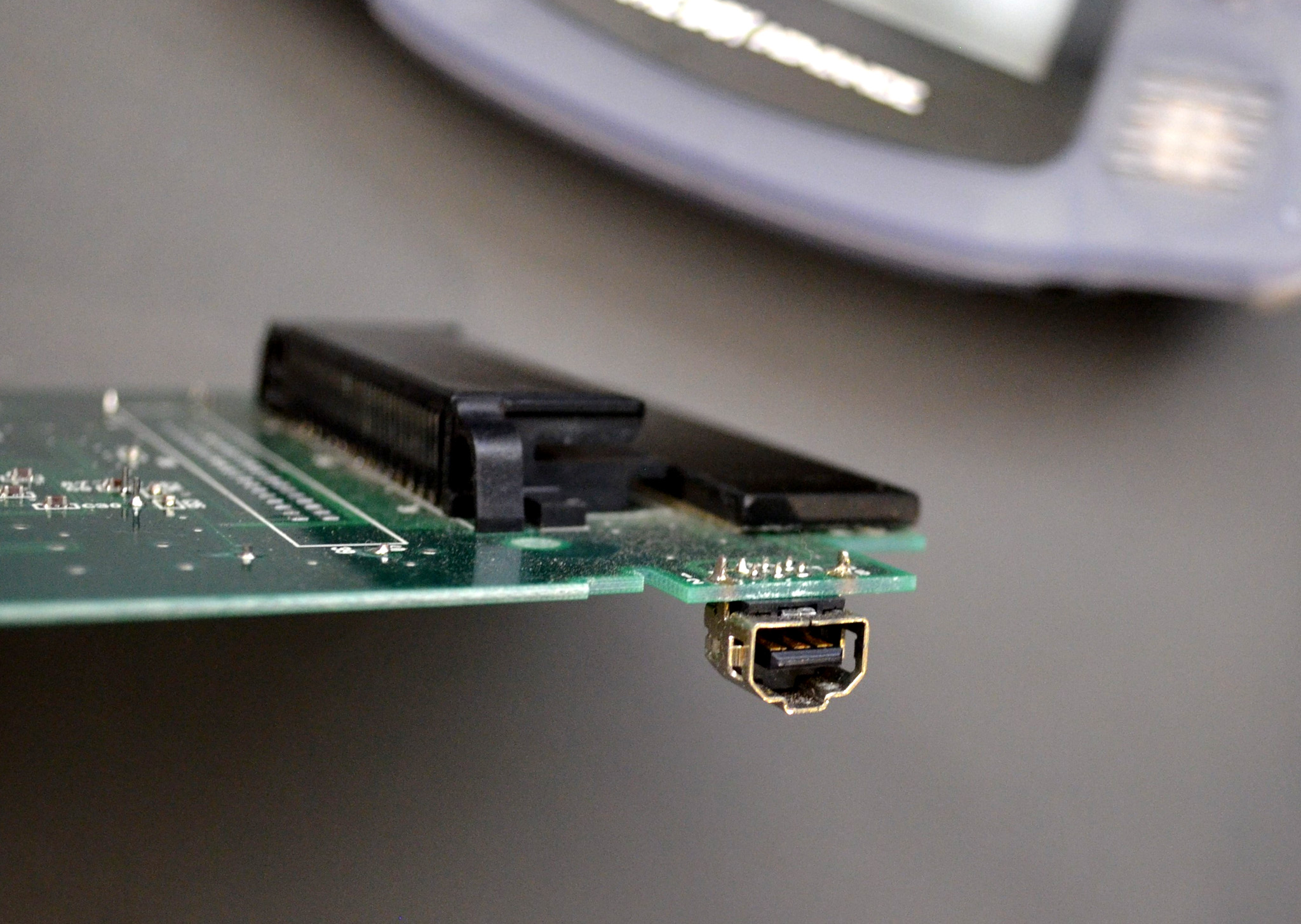

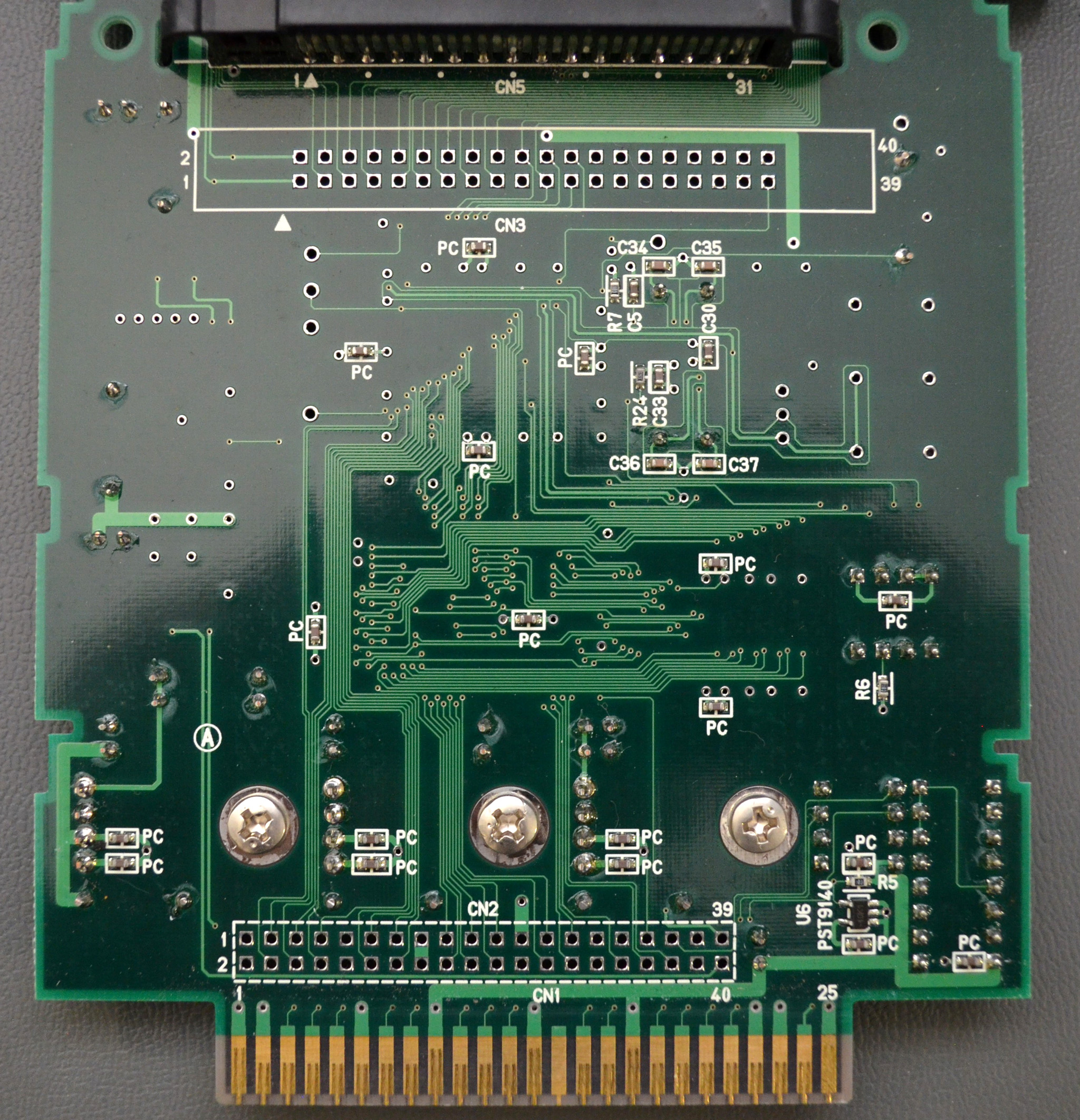

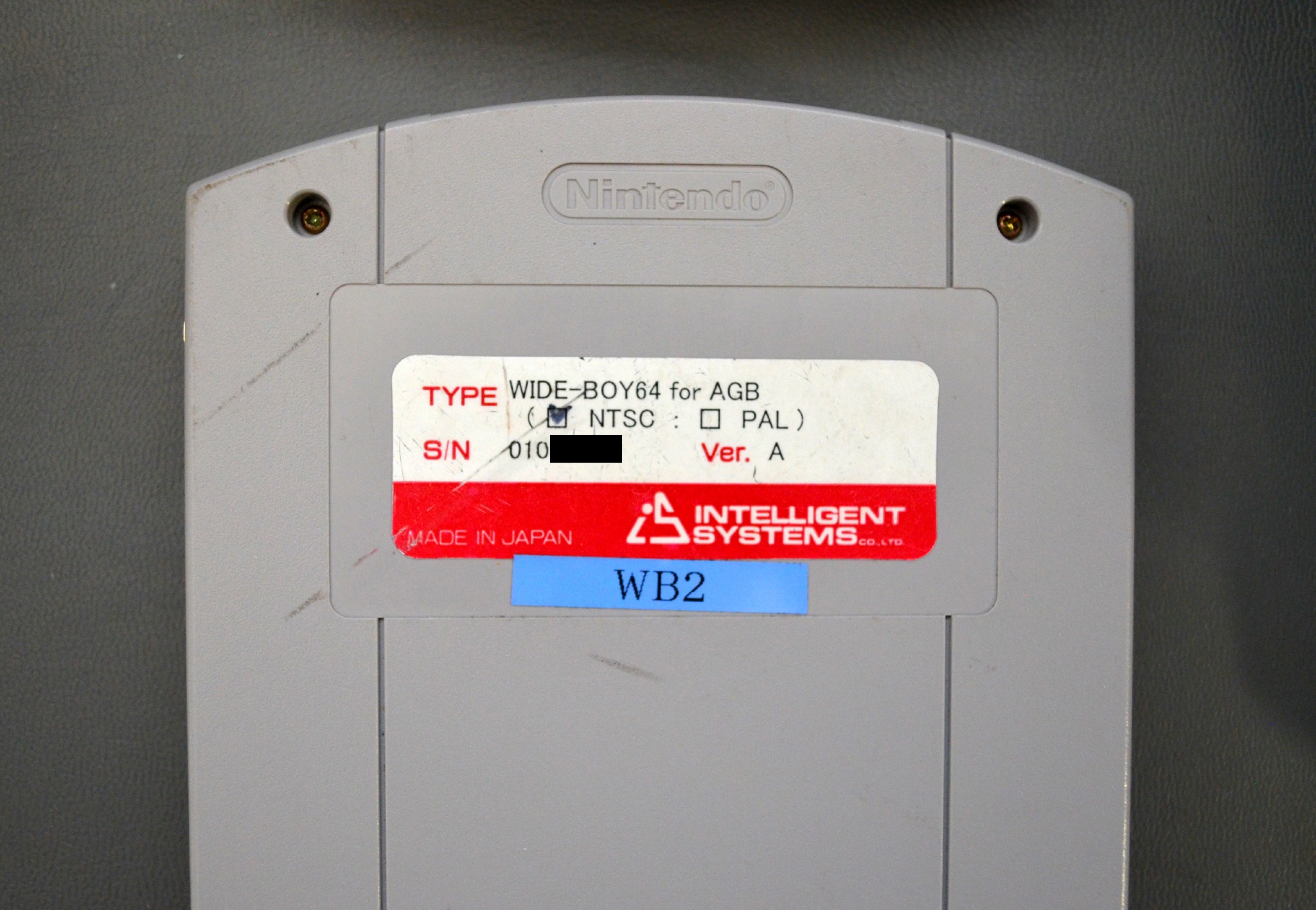

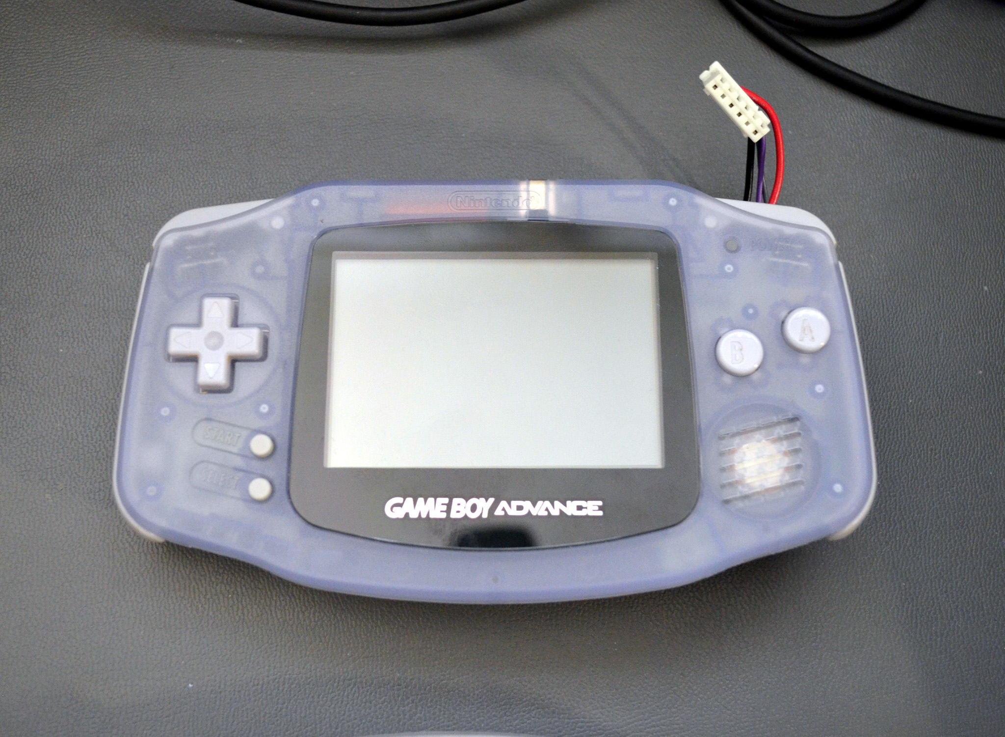

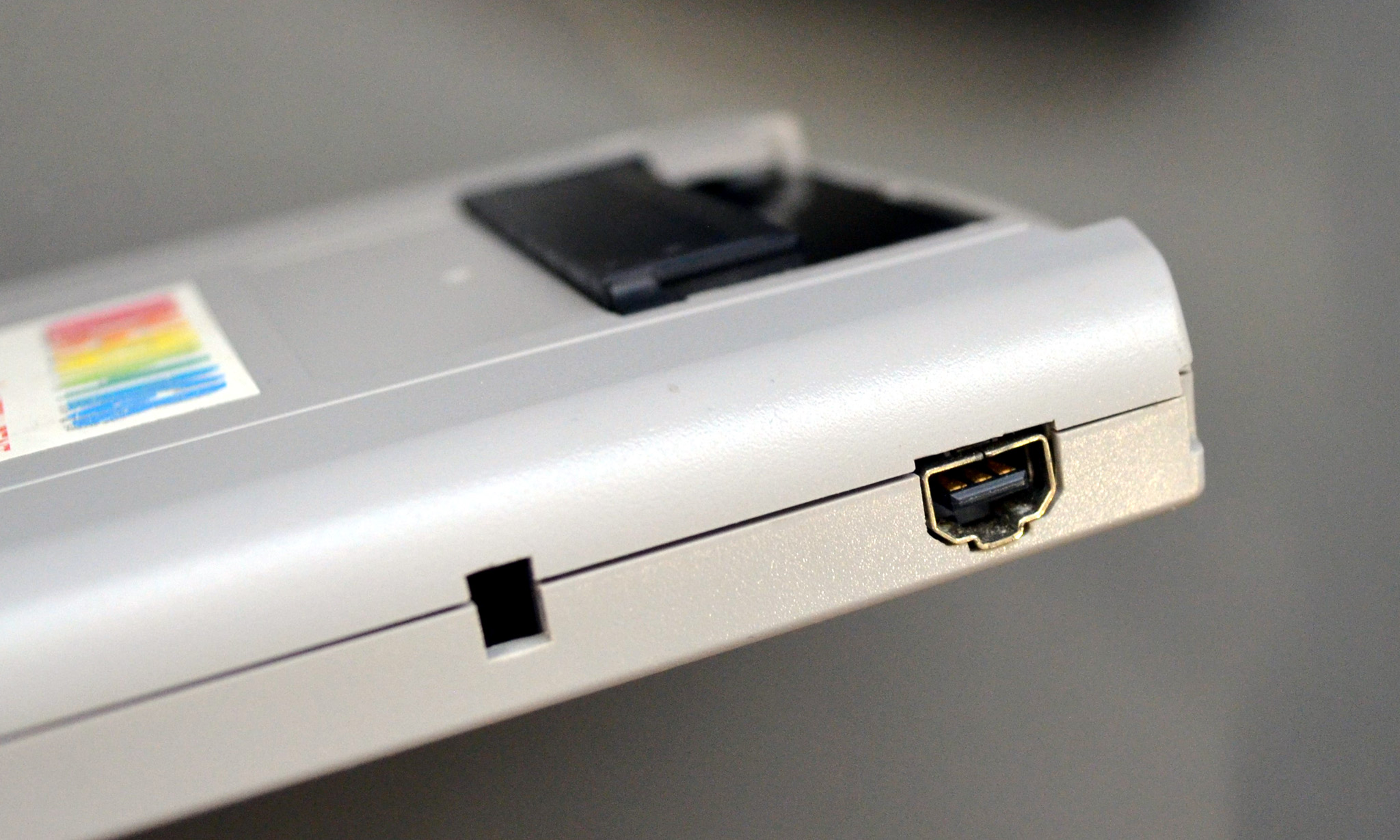

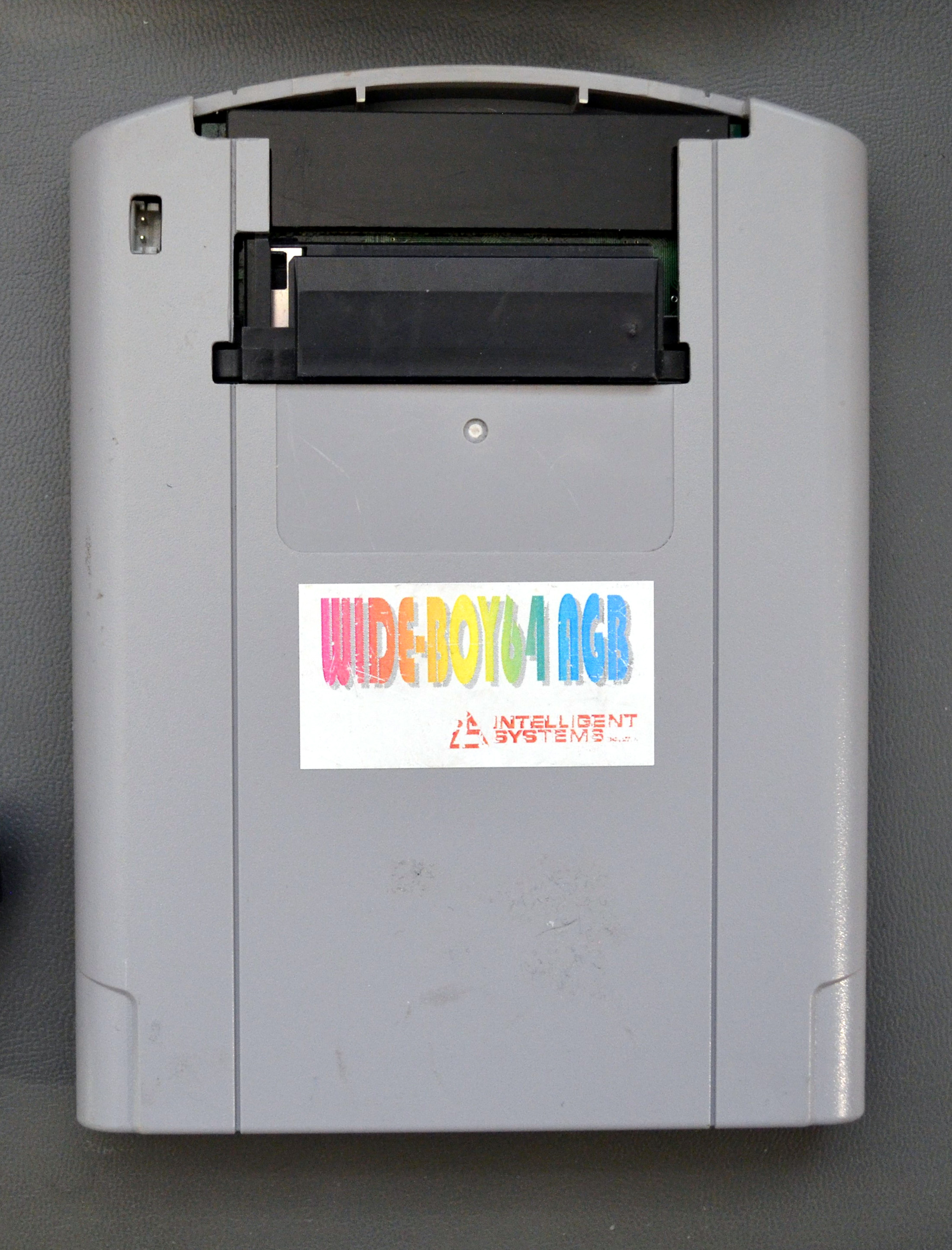

    I recently acquired an "N64 Wideboy AGB" development cart for testing and running Gameboy Advanced games on the N64. I also received some other early Wideboy components.
    The Wideboy AGB cart I have, is the Version "A" cartridge. The Dev cart is actually capable of running Gameboy, Gameboy Color, and Gameboy Advanced games.
    I'm posting some Hi-Res images of the unit below for the archives, including some of the internal PCBA and the other hardware I received. There have been photos posted before...but I wanted to add some higher resolution shots. They aren't the best quality....but definitely higher res than what is currently online. ;)
    Here are some additional Hi-Res Photos:

    Now, I know there was some Firmware posted for these Wideboy units back in the day, on the Intelligent Systems FTP site. I'm wondering if there are any updated links that people could post here? Just wanted to gain access to the Firmware files and/or any documentation for the many Wideboy versions.
    If you have any Links that you think apply to the Wideboy for N64...
    please add them to this post for the archive.
    Let me know.
    Cheers! Folks,
    and Thanks!
    -Gerry :cool:

  3. TriMesh
    Jul 3, 2008
    2,324
    You should be able to capture the FPGA bitstream easily - either connect a logic analyzer to pins 1, 2 and 3 (data/clock/reset) of U9 or remove it from the socket and just clock the data out of it yourself. One thing that's interesting is that the FPGA is an "X" part, but they are using a XC17S20 config PROM, which is slightly smaller and designed for the XCS20 FPGA - I guess the bitstream fits anyway...
