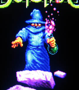

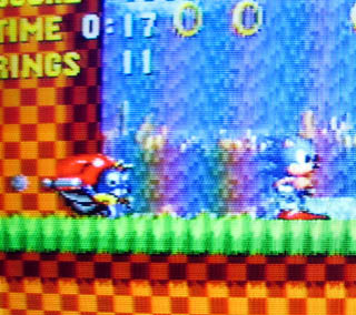

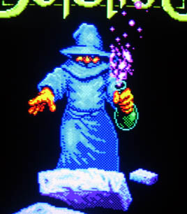

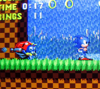

    ^ here is a classic example, notice the waterfall in the background
    RGB on the left, composite on right
    [​IMG] [​IMG]
    or this nes example:
    [​IMG] [​IMG]
    (images from the megadrive and nes sections here: http://www.chrismcovell.com/gotRGB/screenshots.html )
    Didn't knew about them either until a year or so back, they have to do with shading and stuff that mixes colors to create gradients, still they are nice.
    I did test with the water in Sonic1 like in the shots, it does look like transparency effect :D

    Yeah those are pretty much Dithering, or variants. It is a compromise I guess.
    But the shimmering artifacts on the Composite NES or so terribly ugly that I will chose to ditch composite any day.
    Personally Im using S-Video on most of my consoles atm. Including my RGB NES.
