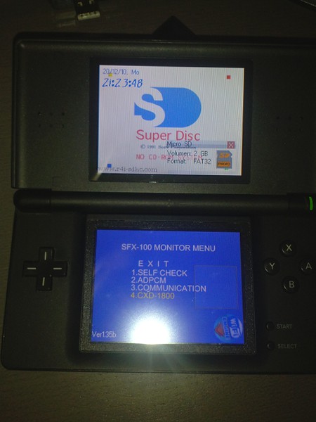

    173
    They powered it up - it played SNES / Famicom? carts just fine, and the BIOS cart ran as well (so at least the ROMs in it seem fine).
    But, the self-tests for the CD drive part failed, which means the controller section of the main board either isn't connected properly (quite a few "bodge" wires around there), or the MCU that controls that stuff isn't programmed (or has been corrupted somehow, but that's fairly unlikely), or they never actually got to the stage of loading games from CD (also unlikely IMHO).

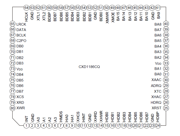

    If we look at the datasheet for the more common "CXD1186" chip, we find... pinouts. ;)
    http://i.imgsafe.org/554492b.jpg
    http://www.datasheet.hk/view_download.php?id=1009114&file=0015\cxd1186cq_138025.pdf
    Well, the part number is from the "1100" series instead of the "1800" that we're looking for, but some of the pins do seem to tally with what we can see on the PCB...
    It looks like most of the Data bus signals match quite well (DB0 to DB7), so it gives some evidence to back up that the buffer chip is sat on the SNES CPU Data bus (apart from being fairly obvious to begin with. lol)
