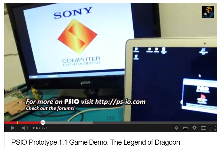

    Has anybody actually watched the videos uploaded by Retro Junkie ?
    Because that windows taskbar everytime the PSX starts is just hilarious :D
  4. reprep
    reprep Gutsy Member
    Jun 8, 2012
    475
    what the hell is this? i just watched the video on youtube and i can confirm the same windows taskbar appears at 1:09 too.
    EDIT: now i am not so sure that it is windows task bar. it might be something related to monitor settings too.

  5. RGB
    RGB Member
    Jul 12, 2013
    A poorly modified emulator perhaps ?

  7. RGB
    RGB Member
    Jul 12, 2013
    Yeah, I figured as much.. The question is, why is there a taskbar displayed for a second or so on the TV screen ? In other videos you can clearly see that it really is the windows taskbar not some monitor settings menu or something.
  8. Bad_Ad84
    1,311
    Doesnt look like windows taskbar at all. Other than its a bar at the bottom of the screen, other than that - it has nothing that looks like windows about it.
    It also seems to happen on resolution changes. I would go with something the TV displays. Probably the channel and which display type (NTSC or PAL etc)
    No clock, no systray, no start menu button, no running apps.
    Just what looks like 2 text entries and only happens on a resolution change.
  9. xdaniel
    xdaniel Robust Member
    Feb 14, 2011
    213
    If this was about "faking a PSX's bootup" or something, why would there be this "taskbar" when booting up a Mega Drive?
    Have no opinion on the whole PSIO business, but really, those conspiracy theories sometimes -.-
  10. RGB
    RGB Member
    Jul 12, 2013
    True, I haven't seen other videos (I'm only interested in PSIO) and that looked like a taskbar for me.
  11. Shane McRetro
    Mar 11, 2012
    2,078
    194
    Hahaha, yep that's just my TV telling me what settings it is running (NTSC, PAL) and which input it's currently on.
    It's a good old mass imported never before heard of brand.
    I know my Samsung has a much nicer interface and shows it up the top left, this one just does a grey bar down the bottom :p
