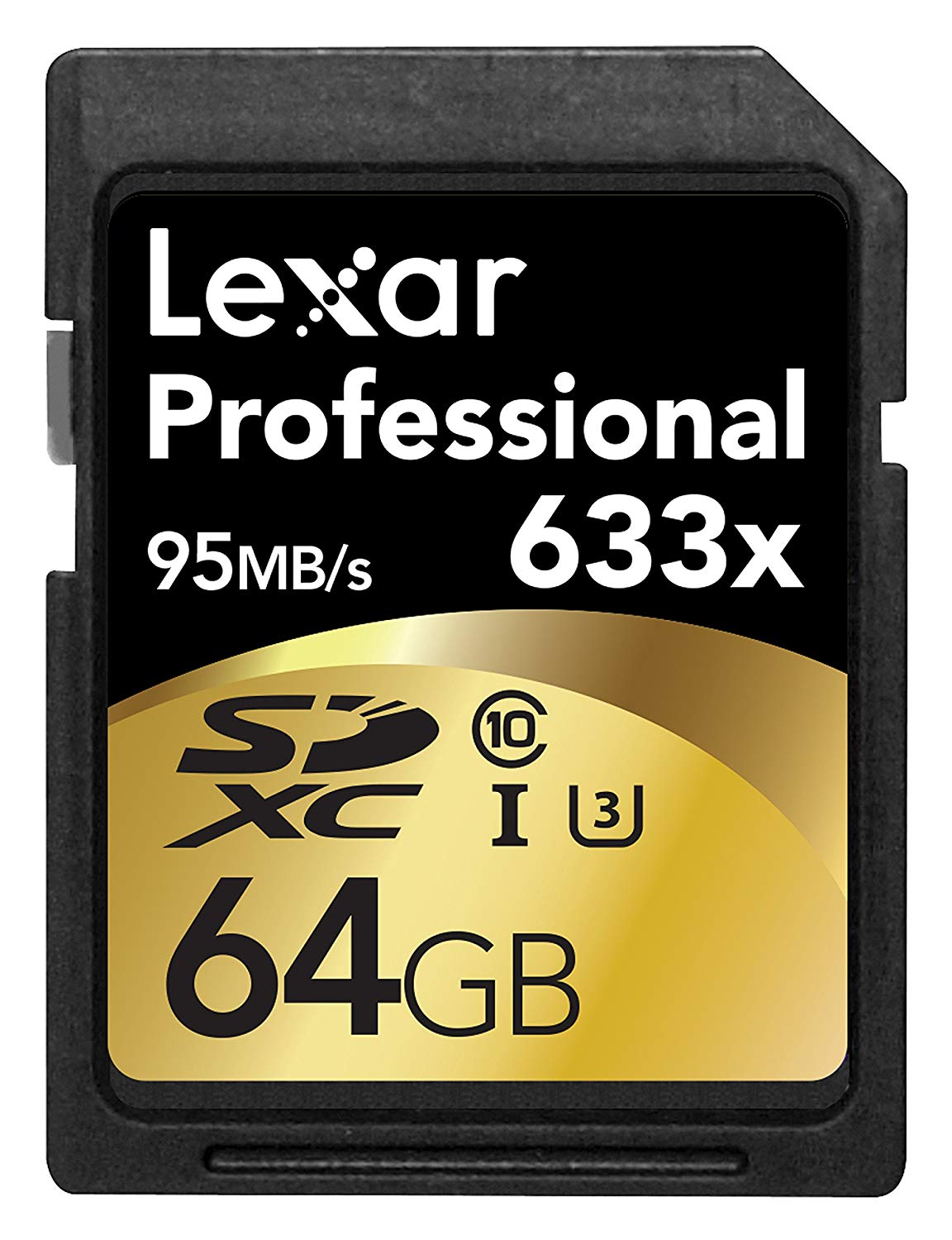

    Well after updating the fw with a Lexar sd card I already had and retrying the menu process, I have everything working properly. Strangely, it now is accepting the sandisk micro sd upon startup, which it wasn't before. For months I had to reinsert several times, now it works flawlessly. Just wanted to let everyone know!

    I edited my last post. I did have to use 3rd party software to change the format to fat32. Sdxc cards come exfat, but Rhea needs fat32.
