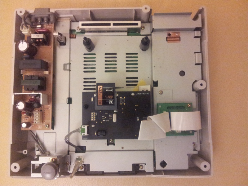

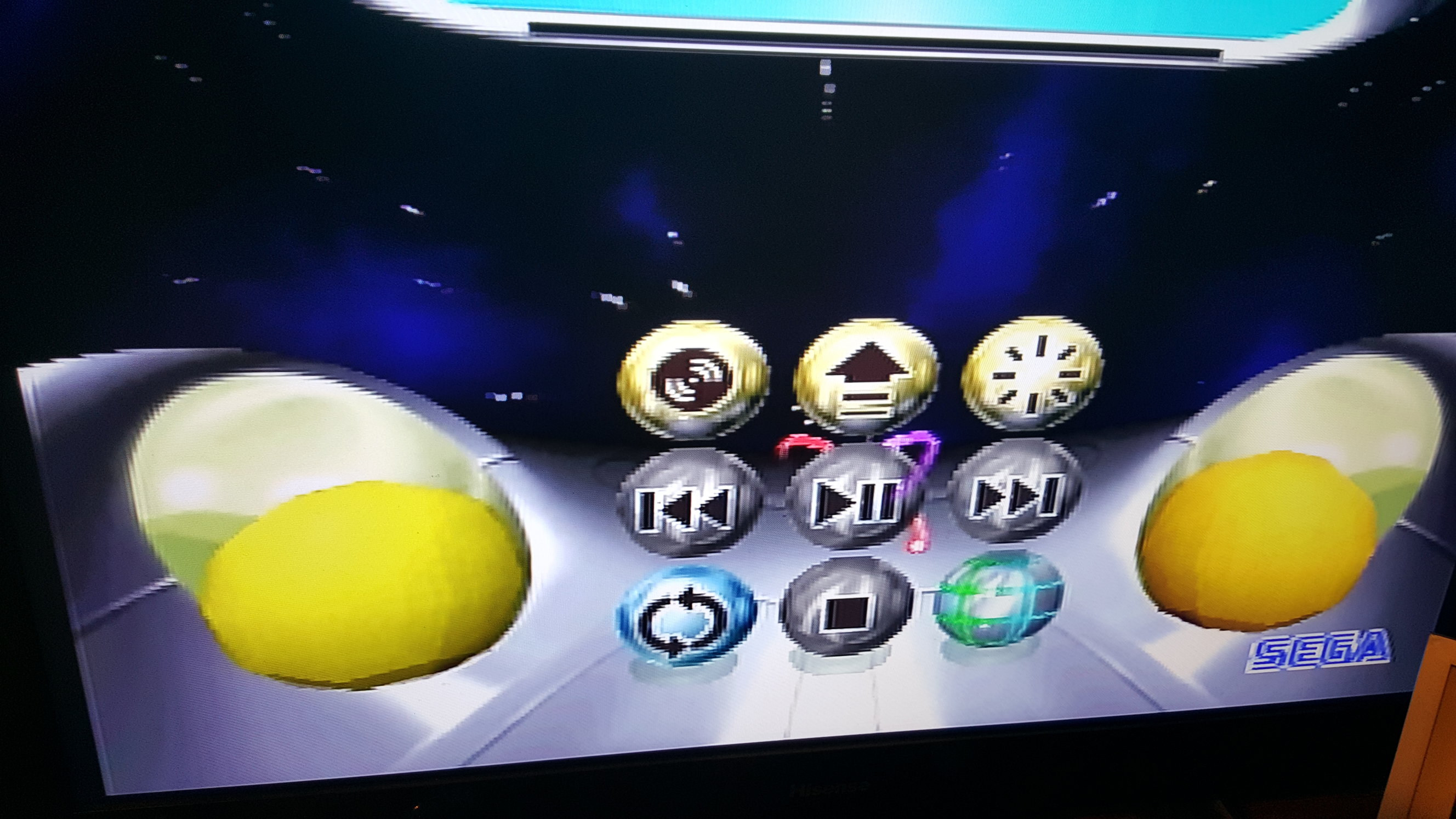

    Saturn is usa type 2, the game is usa region and was downloaded online. The sd card is formatted as fat, I tried fat32 also and it has same result. Is there a recommendation that you have as to what game to try first in case it is a problem with what I downloaded? I also enclosed a picture of the screen on the tv as to what I see with the sd card in and I don't get the typical sega saturn intro screen just a frozen saturn screen. I also just tried the 01 folder with the game in it but coming up with this result still.

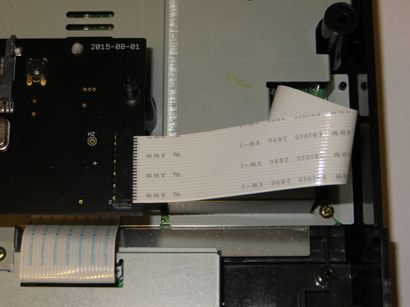

    Jumpers are for your saturn's type on the phoebe ?
    [EDIT] Ok seems good as shown on your picture...
    The flat cable is plugged in good way ?
    See for type 2 on official site :
  4. MeteK
    MeteK Rapidly Rising Member
    Nov 24, 2012
    79
    Yours seems upside down, no ?
    JVizzle32188 likes this.

    It's odd there isn't a "disc drive empty" message or anything. Stupid question, but did you install the ribbon cable the right way?

  6. JVizzle32188
    JVizzle32188 Member
    Mar 26, 2016
    Words can't explain how stupid and greatful I am for the community on this forum. Much thanks and you all are awesome!!!! It is now working as the problem was that one wire being upside down.
  7. Atolm
    Atolm Spirited Member
    Feb 28, 2016
    147
    39
    WHOOPS, hold on. Yours should be conductor side up as Metek posted (I was thinking of the Rhea)
