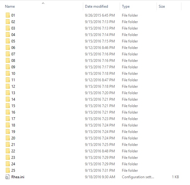

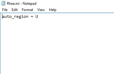

    Post a desktop image grab of the root of your SD card, as well as your rhea.ini contents.
    Your memory card should be formatted for FAT32

    Slashbunny, I'm using a Sandisk 32GB card. Formatted in FAT32 32k cluster. US images play perfectly. With the region set to U or 2 in the ini I still get the "this disc is unsuitable for this system" when I try to boot a Japan image. Same if I set the region to Japan in the ini.

    Your .ini looks correct. Not sure what's going on. Maybe try updating the firmware again. The file needs to be renamed "Rhea.fw" Slide the lock tab on the memory card put it in the saturn and turn it on. The LED should rapidly flash for about 3 secs, and then just slowly blink. Turn off the saturn, slide the tab back to unlock then put it in. If none of this is working, try another SD card, if that doesn't work. Shoot off an email to the guy.
