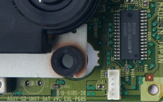

    This is a dumb question....I apologize. I'm trying to identify if I need a phoebe or rhea. As help as his guide is, my Saturn doesn't match any examples. The drive in mine is a JVC EXL P605. I can't find that listed. Mine appears to be a type 4 but mine does not have the white border around the PCB. I must be over thinking this

    Look above the 'JVC EXL P605' - does it say 610-6185-20 like this?
    If it does then according to Zyrobs awesome posts at Sega 16 your machine will be a VA6-9 and should have a 32 pin IC (Which would make it a type 3 Phoebe)
    I would of course double check to be sure though before ordering :)
  16. S_crumb
    S_crumb Member
    May 24, 2016
    Nightbreeduk thanks I never would've figured that out! It does indeed have that number above it. Type 3 Phoebe it is!
