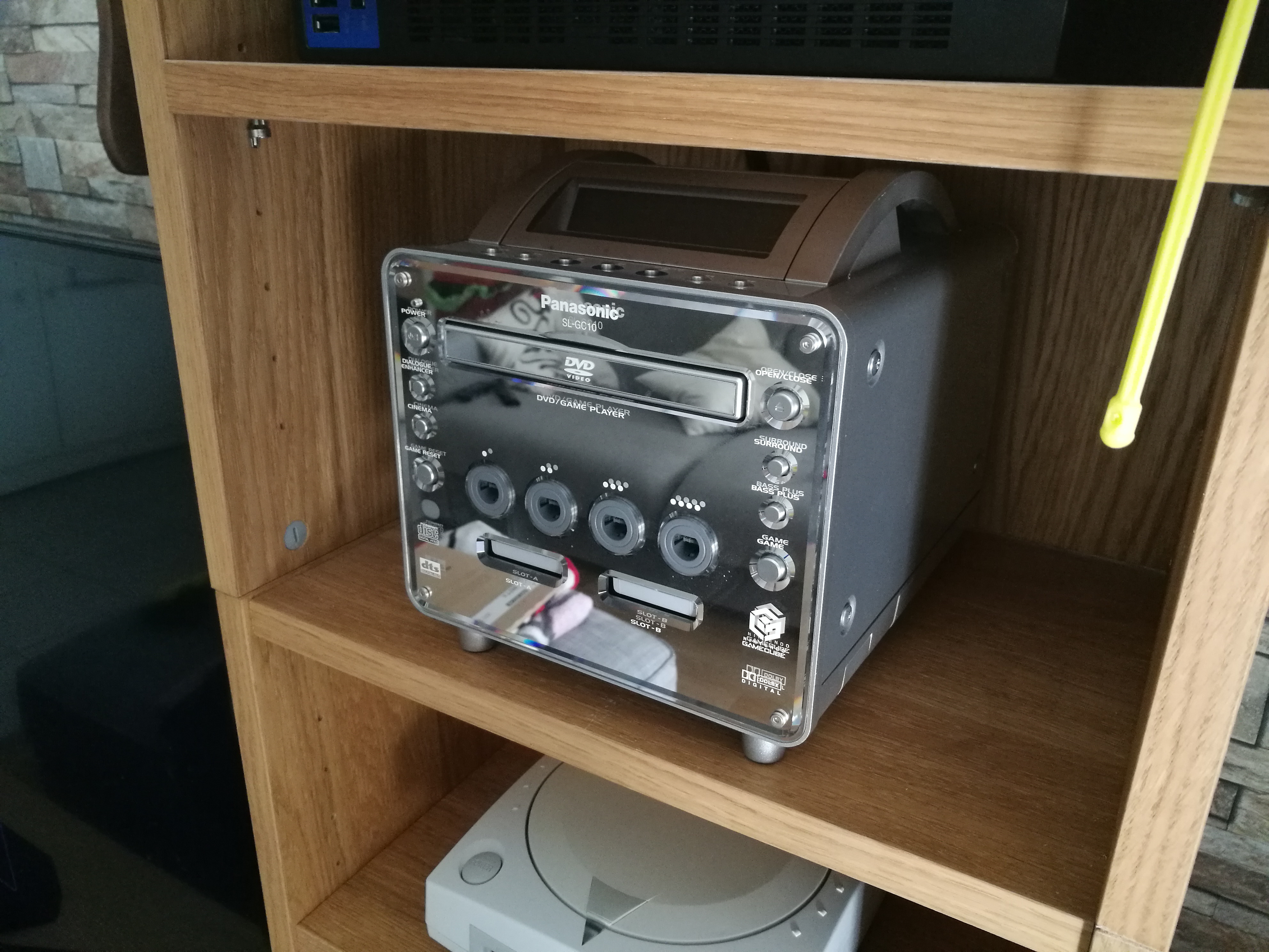

    Hi ASSEMBLERS,
    I do own couples of Panasonic Q console (4 actually). I'm repairing and customizing them. I also switched one to PAL by creating a custom RGB connector and replacing the motherboard.
    I'ld like to get it region free with DVDs so I ordered the below disc. Is that all I need ? Do you know a procedure ?
    Panasonic Service Disc TS20 (disc 2) - Unlimited Trade Dealer edition from multiregionupgrade.com
    Please let me know :)

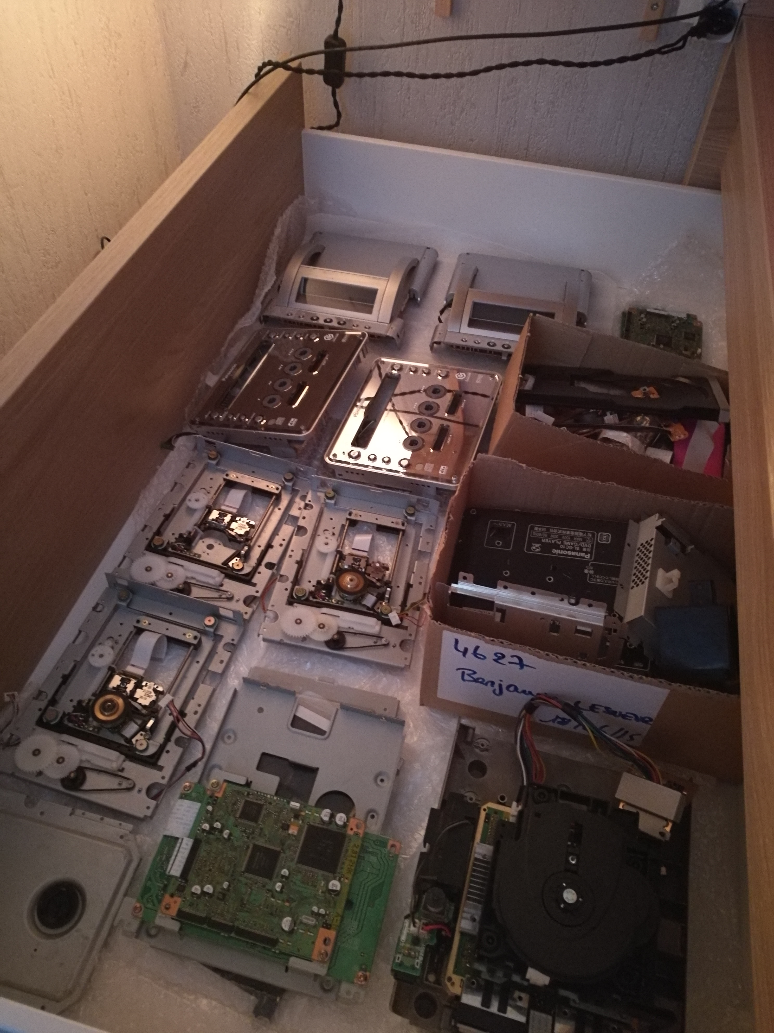

    Yes, I'm also working with a professional plastic modeler so he can recreate that f***ing pieces of plastic that breaks within all Panasonic Q.
    Last but not least, someone on eBay is selling proper rubber band for the DVD tray ! They're working perfectly !

  10. BenjmainLSR
    BenjmainLSR Active Member
    Apr 12, 2016
    Yes. Basically all of them have broken DVD tray and tired rubber band.
    Expect them to arrive with ALL internal plastics partially broken. Except from that, they're fine.

  13. BenjmainLSR
    Apr 12, 2016
    It depends, sometime it only needs:
    Cleaning: to remove dust, grease.
    Glueing: instant glue.
    Paper sanding: to remove excess of plastic and glue.
    Grease: to ensure the DVD tray will slide gently.
    Replace the rubber band ! That's the most effective part, trust me.
