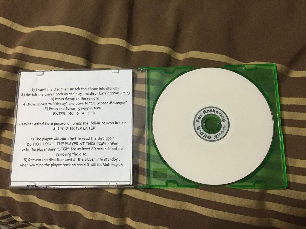

    @BenjmainLSR or @Slypty, would either one of you be interested in modding a Panasonic Q and potentially refurbish?
    This topic has alot of information about the service disc and making the Panasonic Q region free:
    https://assemblergames.com/threads/panasonic-q-and-the-service-disc.51835/
    The iso file for the disc was shared by famiac:
    https://drive.google.com/file/d/0B14RXpId-XGTRTlaalNRZ1I3bUE/view
    Here's an image with the needed control inputs for use with the service disc, also by famiac:
    Here's an manual for enabling PAL playback, shared by JATO:
    https://manualzz.com/doc/4383990/panasonic-sl-gc10-dvd-multimod
    This link has instructions on how to switch the menu to English, and translations for the remote control, also by JATO:
    https://www.gamefaqs.com/gamecube/915781-gamecube/faqs/21988
    Menu to English:
    Remote control translations:
    Not sure how much extra RAM is needed, or if there needs to be some specific SDRAM for the mod, but I guess you extract two RAM chips from an SDRAM stick and solder them according to the guide?
    On a separate note, I was wondering if someone would be able to 3D print a base/case for to use beneath the Panasonic Q with the normal Game Boy Player?
