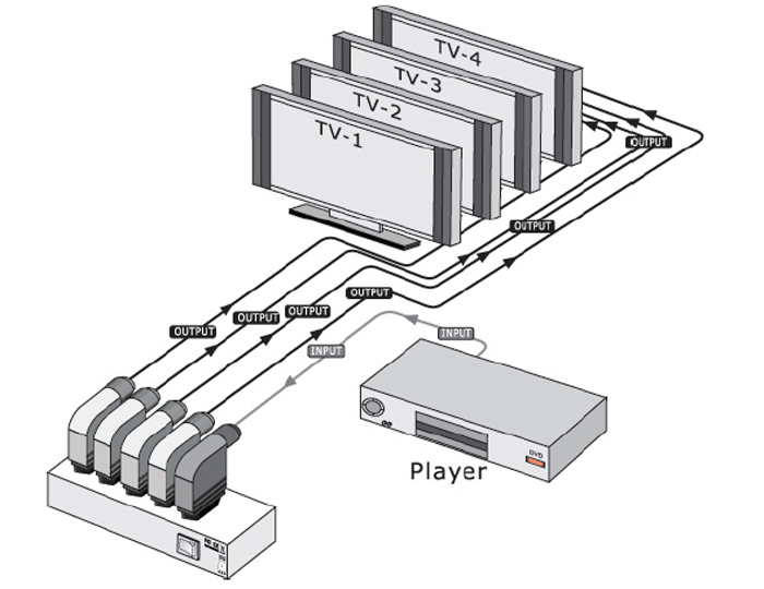

  12. helakustorm
    helakustorm Robust Member
    Oct 16, 2016
    257
  13. la-li-lu-le-lo
    Yeah, that should work, except I'm guessing that thing is kind of expensive. If that's the case, then something like a DVD recorder might actually make more sense – unless it's really important to get the best quality possible.
    helakustorm likes this.
  14. helakustorm
    Oct 16, 2016
    257
    Unfortunately that device is needed for the setup.
    After this, I need to find a capture device to support SCART connection and some connection to PC...
    To tell you the truth I like to play on my Sony Trinitron :(
    It's sad that what I want is not feasible or achievable and I need to resort to Framemeister or OSSC with a capture device or something.

  17. Borman
    The Micomsoft sc-512n1-l/dvi does RGB at 240p, you just need a sync stripper like the Sync Strike, which will output via the VGA connector. Works fine. The capture card also has passthrough so you can monitor the video on a TV without another splitter. Not cheap, but you aren't in cheap territory right now.
  18. Jackhead
    Jackhead Site Soldier
    Apr 2, 2008
    2,433
    610
    I have the Shinybow SB-3715 and it work perfect for me.
    Playing on CRT with streaming/recording over the framemeister to PC is np.
    The AMP do a great job. If tests many adapters and stuff before.
    For me the best result is this AMP.
    I ordered it directly over the shinybow shop.
