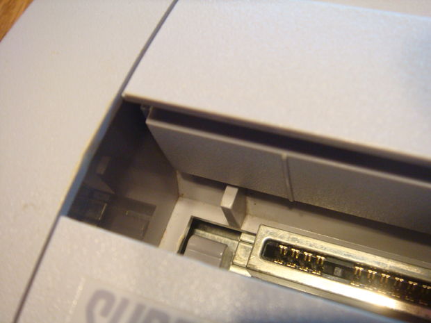

    Clip these tabs. Your snes is now region free to accept any cart.

    Eh. I bought one of those adapters from eBay once and the damned thing didn't work, I got audio and no video. That's why I cut the tabs after taking the system apart, like Koralik did.
