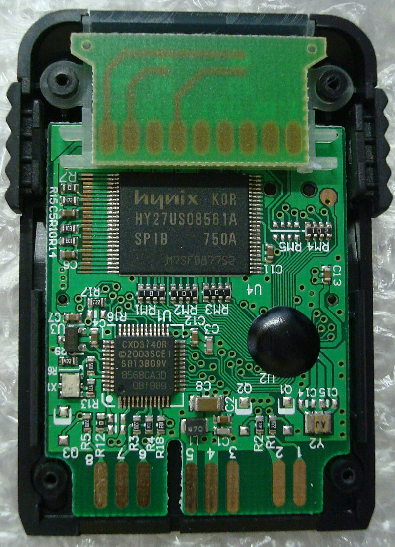

  15. GillBert
    GillBert Spirited Member
    Jul 26, 2012
    101
    39
    I have got one recently, I didn't make much tests with some known games which do not work with fake/larger memory cards, but so far it's working perfectly. I've installed many versions of FMCB on it, from 1.7 to 1.93 and all have worked.
    Although having 16MB of total capacity, it's divided in two 8MB "banks", so that it acts as a 8MB device at a time. It has a button to switch between the two 8 MB banks.
    Here some pics of it:
    As you can see it uses a CXD3740 Magic Gate chip which can confirm that it's really a licensed Sony product. At the right of MG chip there is another one involved in a black epoxi ball which (I believe) is responsible for switching the NAND pages
    Also, its NAND has actually 32MB in size, which means that it's possible to format each bank to 16MB by using MC Annihilator program. So I suppose that the 32MB Katana version is actually the same of the 16MB one.
    sp193 and krHACKen like this.

  17. sp193
    sp193 Site Soldier
    Mar 28, 2012
    2,217
    1,052
    Thanks guys, for sharing on the Katana cards.
    If you took one apart, you will realize that it won't have a Sony chip as it's controller chip. My 64MB cards have a CMD9800, which might be either a clone or generic version of the CXD3740/CXD9600. Those cards appear to support Magicgate fully and properly. However, this might not be the case for every compatible card out there.
    So far, I don't think that anyone has found a compatible card that is larger than 8MB in size, but yet as fast as one.
