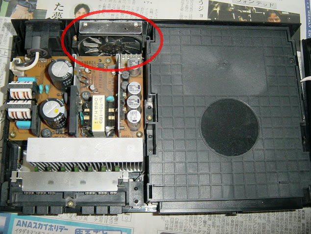

    The drive cover has a flat black disc covering the magnet guide spindle, like in the picture here:
