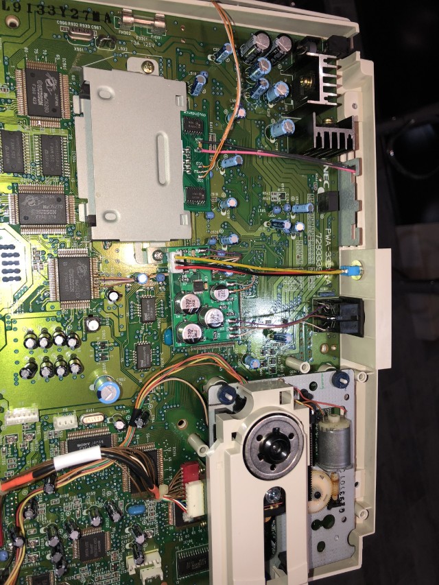

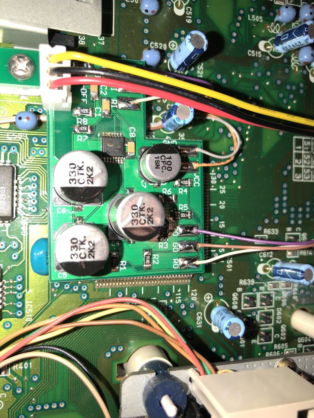

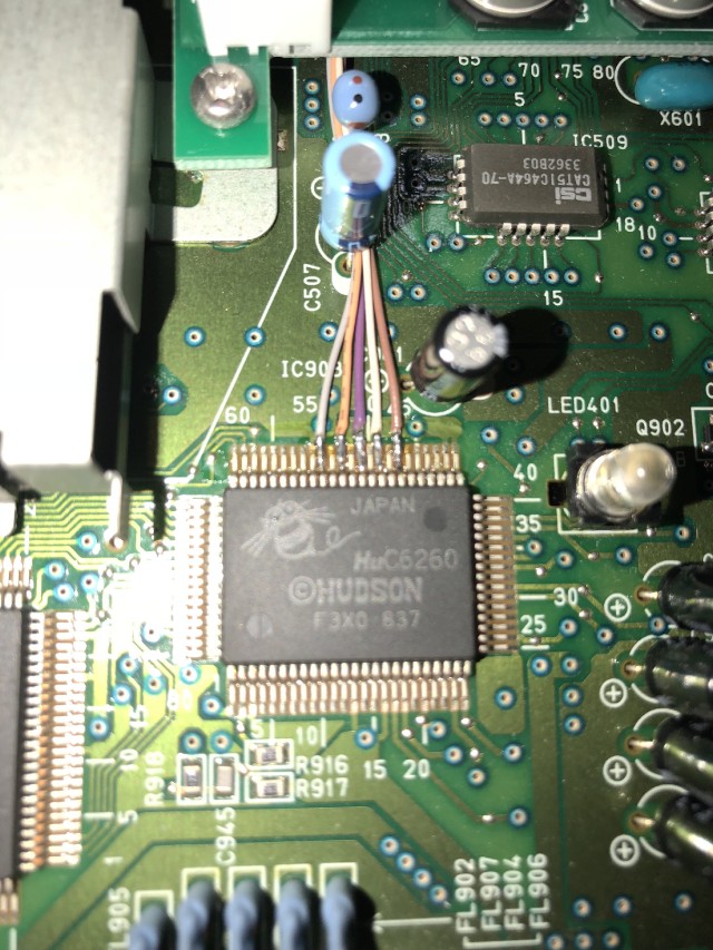

    I finally got around to working on the Disc drive of the Duo-R I bought from Doujindance. Because I stumbled on this post AFTER I made the purchase I was quite disgusted and nervous that I had just pissed away a nice big wad of cash. When I got the system it looked ok from the outside and RGB output seemed correct, but from day 1 the disc drive has been garbage. This made me even more nervous about what I would find inside the unit when I opened it up. Luckily I was pleasently surprised to find that it seems Doujindance has improved dramatically compared to what voultar posted. The story is not all posotive though - I could not get the drive to read reliably by adjusting the pots so I had to buy a replacement laser assembly - for the price I paid for the console it should have been flawless. If it wasnt for this thread id have been more mad about the disc drive, but instead im just thankful that the mods werent a total disaster.
    As promised here are the pics:
    Edit: the replacement HOP-M3 laser was extremely easy to install (wayyyy easier than replacing a PS2 laser), and without even having to touch the pots it works great! I’ve been playing Rondo of Blood off of TY CD-R and even the redbook audio is flawless! Now if only I could find a HOP-E1 for my PC-FX.....
