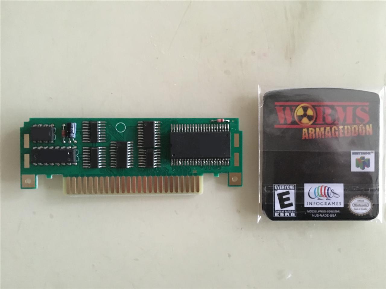

    Anyway here are the pictures I saved from aliexpress
    From those pictures I can make out the following chips "74HC573", "74HC00" and "ST M59PW1282", just need the last one, it starts with 74HC and has 16 pins but I can't read it.
    gwald, Chagosan and gorgyrip like this.

    Wow! Thank you so much! You can re-flash those. In the last picture, it's an official CIC.
    Do you remember the price of those carts?
