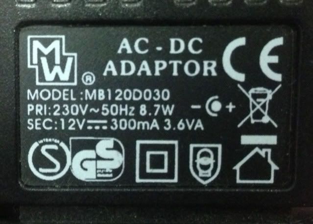

    As part of my quest to solve my SCART to component converter's buzz, I'm now looking to a different AC adapter. The reason being, the one it came with has a Euro-style plug, and the converter it came with fits REALLY REALLY loosely in the outlet. Seriously, it wobbles if you bump it. I'm thinking there might be some arcing that's introducing the buzz or something. So, I thought I'd find a local replacement with an AUS style plug . Here's the adapter's specs:
    I assume that "PRI" and "SEC" are "input" and "output" in some crazy language? So that means I need an AC adapter that's 12 volts, 300 amps and... Is that suppose to be 3.6 watts? Anyway, I need an ac adapter with these specs right?

    As long it has similar voltage, the same or greater amperage and the same polarity you're fine.
  3. MaxWar
    Aug 13, 2012
    1,486
    The outout is 12V DC with the positive lead on the center. If your new adapter is more than 300ma, its not a problem at all.

    The explanation to this is that the number of amp/milliamps written on the adapter is its current rating, not the actual amount of current that will flow. The actual amount of current being drawn into the circuit is determined by the load, not the ac adapter.
    The amount of current that will flow depends of the Ohm law. I = V/R ( current = voltage/resistance )
    So if you have a small circuit that draws 50 ma at 9v and you power it with a 1amp brick, this means that the amp will only be working at 1/20th of its capacity, you could then power other circuitry at the same time. This is also why a guitarist can power several effect pedals with only one AC adapter and a splitter.

    Edit: Also, WRT the OP, "PRI" means "Primary" and "SEC" means "Secondary". This terminology exists because in the not-so-distant past, those wall warts contained conventional step-down transformers. The primary winding received power and the secondary winding output it. These days it's not so relevant because wall warts are mostly switch-mode power supplies now, and while there is a small transformer in there, it's not what produces the output.
