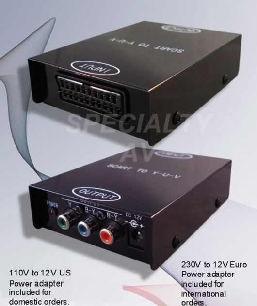

    Hey guy's found something interesting with my RGB/component converter. I have 2 of these bad boys, 1 for my retro TV, the other for my dreamcast to my LCD TV (yes I know VGA is better).
    When I hooked it up to LCD TV I had awful looking lines going over the screen, I thought shit what is going on here, swapped cables over, swapped the converters over..nothing, same thing. So I swapped the power supplies over. Fixed it!
    The first one I got (bloody hell 2-3 yrs now?) it came with a 120V adaptor, useless as tit's on a bull here so I bought a power supply from Jaycar with close specs (12vdc 0.4amp). I used it on my retro TV for a while, but didn't really notice (or maybe ignored?) these faint lines on the screen. When hooking it up to the LCD TV these lines were AMPLIFIED, holy shizzle-my-nizzle it was bad!
    The 2nd one I got came with a 240v power supply (albeit with a shitty adaptor that I replaced), this one works fine.
    I tried further, I have an older variable output (via a switch) power supply (still switchmode) and this worked a charm as well. So this power supply (paid good money for it) that I got from Jaycar is a piece of shit!
    With the variable power supply (I noticed when doing the audio mod the RGB/Component converter has a standard 7805 regulator in it) I switched it down to 9V and ran it for a while with no issues. I have a bucket load of 9VDC adaptors, so I will make one to suit.
    It actually beats me why the hell these guys want to shove 12Vdc into them, the +ve pin goes straight (there is one small filter cap there) to the input leg of the 7805. These get pretty warm to with 12VDC, there is no heatsink on the voltage regulator, so I reckon 9Vdc will be much kinder to it.

    Hmmmm, so you're thinking the ac adapter might still be the cause of my audio issues with the SNES? Even if I'm not getting the picture lines you're getting and the ac adapter is 230v?
  16. omp
    omp Familiar Face
    May 22, 2011
    1,017
    No probably not, the power supply these come with seem pretty good. You could just give it a go, if you have a 9vdc power supply with centre positive 2.1 x 5.5 dc tip on it.

    Yes replacement adaptor fixed the problem. I have quite a few different types, the best type was the type I didn't expect. They were fairly cheap ones bought from ebay, on the outside though they look like a very nice quality power supply. They have written on them "Mobitronic". I also swapped the power supply for my other RGB converter. These power supplies are a big over-kill at 9VDC 2amp, but at least they work nice and it is what I had laying around.
    The power supply I expected to be good (they are fantastic for consoles, never had any issue's) had very slight interference, but not as bad as the original power supply I was using (the Jaycar one).
    Again I have no idea why they want you to shove 12vdc into these things, they only have a 7805 voltage regulator in them. All it does is create more heat.
