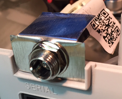

    I have the same problem with all 4 PicoPSUs I bought. Diagnonal lines of crap running across the screen. This ONLY happens on 3rd party Scart cables though. I have one original DreamCast Scart cable and the picture is perfectly fine with it.
    Location of the PicoPSU have no effect. I moved it 40cm from the dreamcast when I tested one and still the same thing. I also tried encasing the pico in a metal box with no difference.

    Its actually a bit of shielding from the top of an Amiga motherboard that I folded and cut by hand and eye measurement. I also found a sheet of metal I had laying around that I used later. I used some old scissors to cut it to size and just bent it with a piece of pliers. Easy.
    Drilling the hole was quite hard though. I learned not to drill the hole before I start cutting into it too much. The hole needs to be nearly the size of the visible section and I ended up ruining it a few times..
