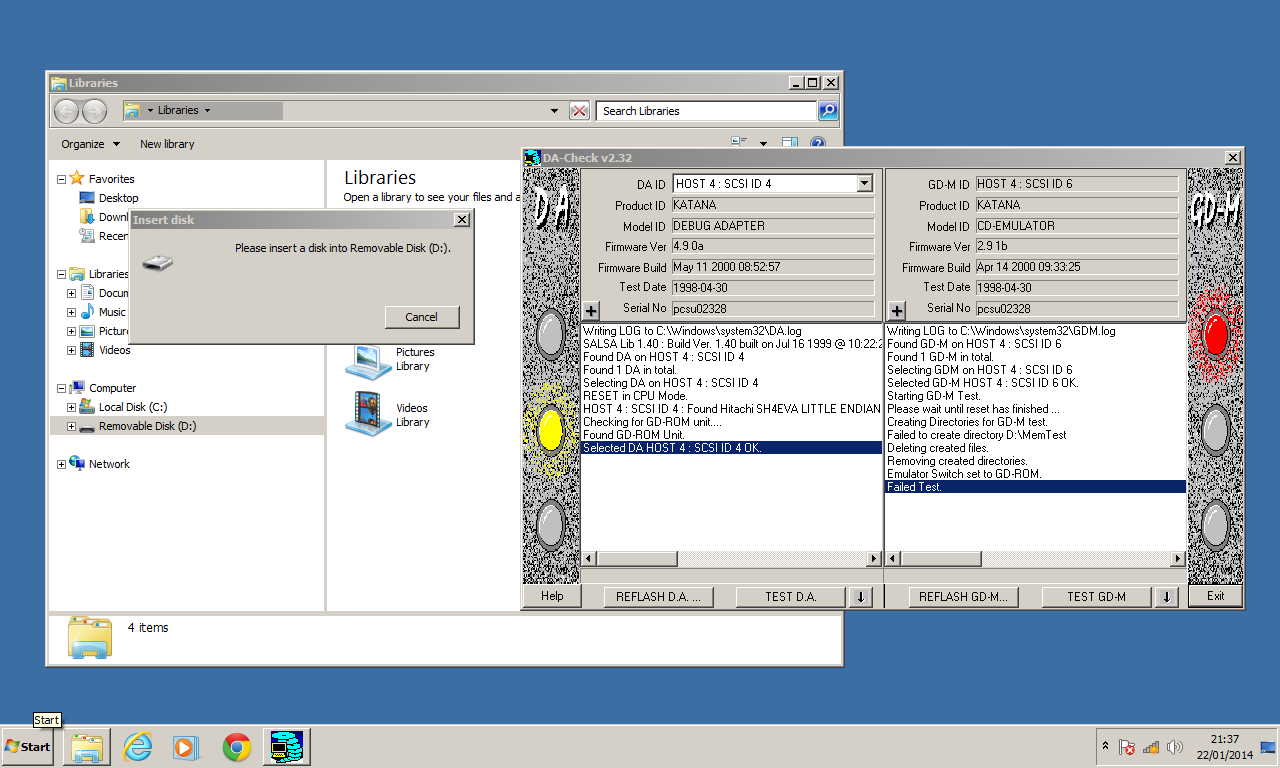

    Firstly T_chan, thanks so much for your help with this dude. You've restored my faith in the internet!
    on boot i do see two devices. here's a screen grab of both trying to browse the 'd' drive (can windows 7 even read old-skool FAT?) and also trying the GD-M TEST.
    I THINK I can just format this drive as NTFS, right? But I'd hate to loose what I'm told is on it's HDD.
    Win7, pretty much a fresh install and used the tutorial here to get everything up and running.
    On the previous problem, it looks like it was because I was not set to VGA. (I was enjoying Picture-in-picture, which oddly only works with composite inputs on this first-yen Sony HDTV/Monitor hybrid I use for this cornet of the games room!)

    If the drive is formatted as FAT16, you won't be able to read it in Windows 7. FAT32 would work fine however. It's possible you're getting that error because the drive itself isn't working though, IE, it could be physically dead and not even spinning, still, that will become clear later if this is the case.
    Before doing ANYTHING to the drive though, you should take a full disk image. This is not a file copy, it's a physical disk image, and you can take one of these even if Windows can't understand the filesystem or even if the filesystem is corrupted. Taking a full disk image is essential, as often people might just "shift+delete" the drive contents, but the files are still there, and a disk image will contain that data, which can then be recovered, possibly revealing beta versions of a game the previous owners thought they'd removed.
