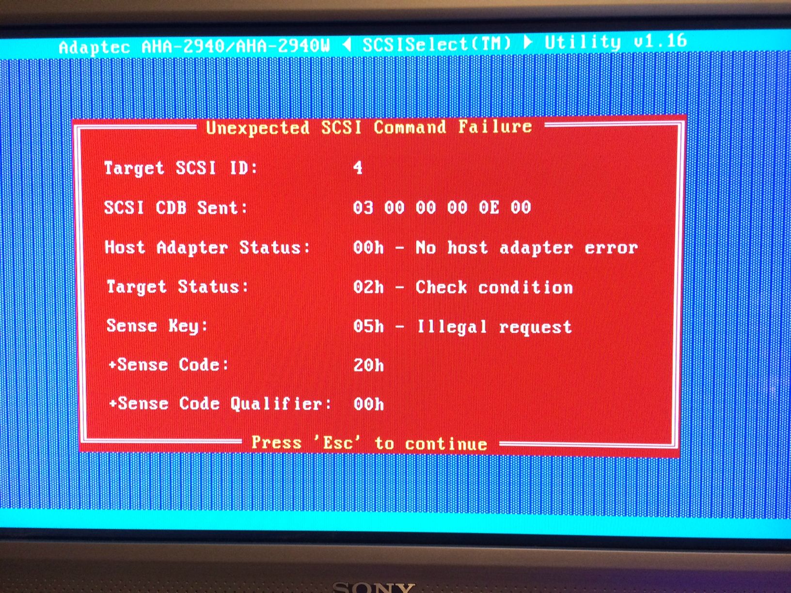

  3. CHAOTIX
    CHAOTIX Rising Member
    Jul 6, 2013
    51
    UPDATE!
    So I tried a low-level format using the adaptec bios bs. :D This happened:
    Now off my bang my head against a wall ! - Anyone got any ideas? perhaps it's the drive? Do only those smaller HDD's work?
  4. ASSEMbler
    You should partition it for 2gb fat, or 4gb fat32 ? I would use a linux utility cd to do the partition and format.
  5. CHAOTIX
    Jul 6, 2013
    51
    Thanks - I'll look into that ... so the fact that I can't format via the bios / get that error message is nothing to really worry about?
