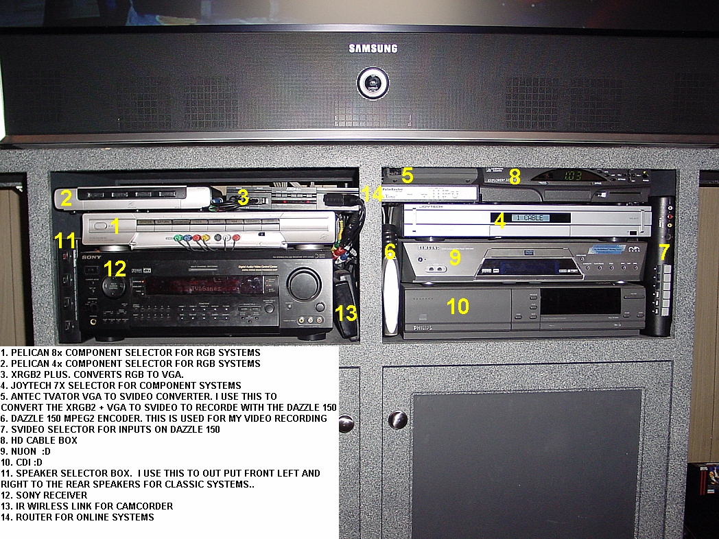

    This is a bit old but mostly the same. Have a Denon now Sony died but was replaced by time i repaired it.
    Short story,
    I dont use RGB scart, I use modded component cables.
    Long story,
    i ordered a bunch of needed scart cables for the special connectors for systems like snes,saturn ect,
    http://www.lik-sang.com/search.php?query=rgb
    some sytems i just have a custom db9 on.(nes,3do,cdi,duo ect)
    i then bought a bunch(12+) of component xbox 360 cables dirt cheap on ebay.
    360 cables are the only ones with 7(r,g,b,sync,left,right,gnd) conductors because they keep the composite line.
    i hacked off the scart connector on the scart cables and hacked off the 360 connector on the 360 component cable.
    used the r,g,b on the component cable as r,g,b from the systems and used the yellow(composite) as sync and right and left for sound. then i used the shield as ground.
    now i just have all my rgb systems hooked up to a pelican component selector box.
    the out of the pelican box has a cable converting component rca cables to the japanese rgb standard that is in the xrgb2 plus.
    on the pelicacn box i scratched off the the black paint on each button then printed my own lables that now light up for my classic systems(genesis,neo-geo,duo,snes,nes,3do,saturn ect)
    i needed 2 component boxes. one pelican 8 selector and a pelican 3 selector.
    i used y splitters to connect the 2 boxes i just turn one off that is not needed.
    (nes.snes,n64.genesis,saturn,dreamcast,neo-geo,duo,3do,jag,cdi)
    in the end it has very nice clean look and a great picture.
