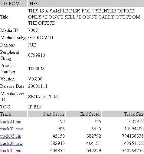

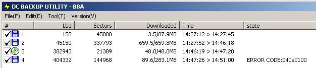

    This is the problem I have with DC-BACKUP, It doesn't dump the last track further than that:
    So I tried with htppd-ack, I followed the procedure posted by ackmed, got this from the ipbintoc page:
    I dumped all the data tracks, track01 and 03 have the correct size, but the dump of the track05 is only 329129472 bytes.
    I extracted the data using Familyguy's Gdi2Data, it worked except that around 150 files were missing, or rather have a size of 0 bytes, including 1ST_READ.BIN wich leaves the dump pretty much useless...
    Then I tried to dump a retail game, everything was fine, including the data extraction.
    Any ideas at what went wrong?

    It sounds like your disc is scratched. What does httpd-ack show on your TV when it stops transferring track05?
    By default httpd-ack will abort the transfer if there is a read error. You can bypass this if you change 'abort1' to 'abort0' in the download link for track05. Sectors that cant be read will be filled with Q's.
    I would also suggest changing sector_read16 to sector_read1 in the download link for track05.
    -ack
