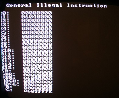

    I tested out a Video CD today, noticed the "Potential Video CD Detected" screen, then it jumps to this crash screen.
    I guess it broke after all^
    Occasionally I like watching VCD's in my bedroom or at my cousin's house, so a fix would be appreciated!!

    You do have the VCD hardware expansion?
  18. quazz
    quazz Member
    Dec 7, 2011
    Yup.

    Sorry had to ask the obvious.
