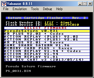

    After thinking instead of simply coding, I realized that as pseudosaturn flash utility could successfully flash Memory Card Plus, there is no need to add any support for any new flash chip ...
    So, if needed, please use attached flasher utility in order to restore Memory Card Plus firmware.
    View attachment 20140817_memcardplus_flasher.7z
    In order to avoid bricking cartridge because of bad reflash, flash process is not processed in the case flash chips are not recognized (because of wrong connection with Saturn, for example).
    Source code, screenshots, and more explanations can be found >here< on my homepage.

  14. cafealpha2
    cafealpha2 Site Supporter 2015
    Jul 4, 2014
    280
    Thank you for the link !
    I know you posted it before, but couldn't find it.
    Can you let me know about the firmwares that must be listed in flash utility, and the firmwares that are not really needed ?
    ARP_201.BIN
    ARP_202.BIN
    ARP_202C.BIN
    ARS_181.BIN
    ARS_194.BIN
    ARS_194C.BIN
    GSS_196.BIN
    PS031.BIN
    PSEUDOSATURN.BIN
    The utility I'm currently making is standalone (= can be uploaded via USB datalink, without the need to burn CD-R), but as a consequence, I'm limited in memory space, so that I want to prune firmware list.

    ARP = Action Replay Plus (any version as they all use the same firmware)
    ARS = Pro Action Replay by Datel
    GSS = GameShark by Interact
    PS031 = the latest PSEUDO (could be renamed I intended to name that 0831 [just a typo])
    + Your dump of your Memory Card Plus.. but to save a tiny bit more space dump, that without the saves
    both the C versions just have extra codes so you only want
    ARP_202C.BIN
    ARS_194C.BIN
    GSS_196.BIN
    PS031.BIN
    Memory Card Plus
    You may as well wait for Cyber though as there is another release currently being worked on

  17. cafealpha2
    Jul 4, 2014
    280
    Thank you for the informations !
    I added compression to each firmware data, so that they all fit in one flasher binary. (one flasher to rule them all :D)
    In the future, if I add new firmware, I will remove the useless ones in order to save space.
    I will update the flasher stuff when new pseudo saturn firmware will be available.

    Beta version of flasher utility is ready !
    Any volunteer to test it on real hardware so that I can release it safely ?
