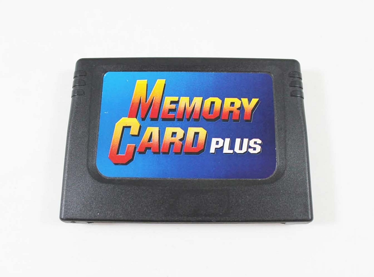

  8. hey
    hey Member
    Aug 9, 2014
    http://www.lukiegames.com/assets/images/sat_memory_card_plus.jpg
    This is the version of Memory Card Plus that I successfully flashed with .831. It does not have 1M/4M RAM capabilities, but appears to bypass region protection. I have been testing it on a Model 1 NTSC North America Saturn.
  9. cafealpha2
    cafealpha2 Site Supporter 2015
    Jul 4, 2014
    280
    I dumped its firmware a while ago. Please let me know in the case you want to restore its firmware.

  12. cafealpha2
    Jul 4, 2014
    280
    I don't have PLCC socket adapter too :)
    Instead, I connected SD card reader to pad2 connector, and made Saturn program to save flash memory contents to SD card.
    I will try to make utility to reflash memory card plus, but I currently don't have hardware (only yabause) to test it.
    Is there somebody ready to test this utility ? Please note that you will loose your cartridge backup data after reflash.
    And, I'm not responsible in the case I brick your cartridge and/or damage your Saturn.

  16. cafealpha2
    Jul 4, 2014
    280
    I think that it is better to be able to restore back firmware than not being able.
    I'm not sure whether AR flasher can recognize flash chips for writing or not. That's why I would like somebody to test.
  17. kuze
    kuze Peppy Member
    Sep 28, 2011
    371
    So what's the most common / cheapest of the compatible carts for this?
  18. cafealpha2
    Jul 4, 2014
    280
    IIRC, memory card plus PCB is slightly thicker than usual cartridges, making them not working correctly after plugging memory card plus for a long time.
    I just took a look to my memory cart plus firmware dump, and it seems that its Flash ROM size is 2MB or maybe more, so without doubts, it will not be recognized by AR flasher utility.
    Hey, can you execute diagnostic program on your Saturn with memory cart plus inserted ?
    You just have to burn iso on CDROM, load it on your Saturn, and report Flash IDs here. It won't erase anything.
