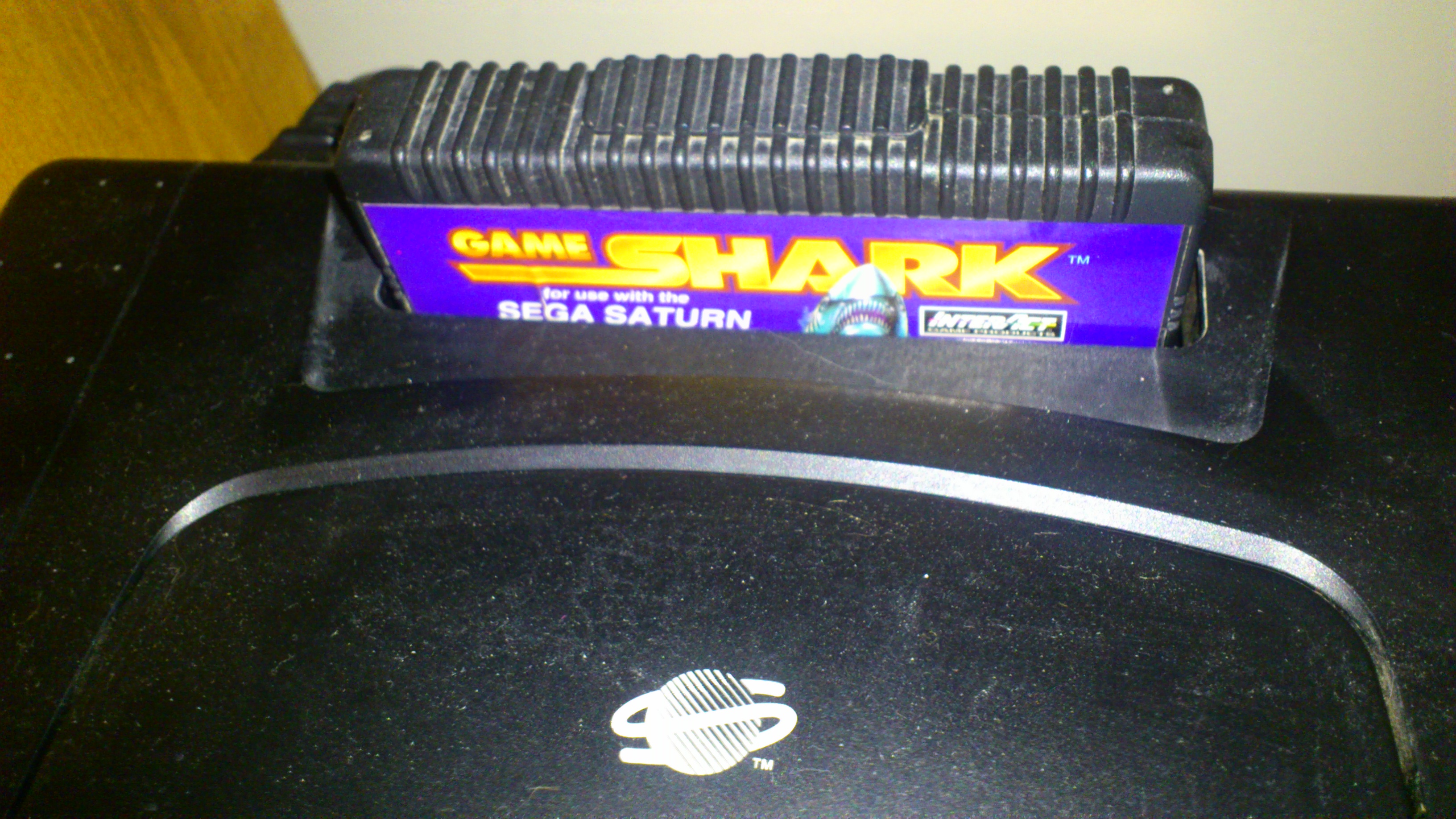

    As you probably already know, the Gameshark cart has to be set just right in the cartridge slot for it to be recognized by the Saturn. What I do is insert it and push all the way down, then pull it up a bit.
    Maybe this will help - I took a pic so you could see where the Gameshark ends up sitting in my Saturn:

    Ive tried ATLUS, Cafe's and the original flasher to no avail. I'll setup my HDPVR for capture later this weekend. I also had the GS Cart up a few cm and not totally flushed in.

    Heres a video of what Im running into. Forgive me on the Double Audio..this was a quick and dirty upload to show you guys what Ive been running into. The cart is raised up a few CM from the port base, much like orcanaoftimes's picture shows.

    Ah OK, so it is just a mechanical issue. Hence it is common to both Atlas/Flasher/whatever :)
