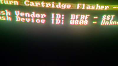

    I don't own ST key, but looking at ST key pictures shows that something is connected to its full data bus and that enough address lines are used in order to guess that some flash memory can be found inside it.
    Can you try the attached flasher utility with your ST key ?
    You will need a modchipped Saturn, or using swap trick in order to run the utility.
    If you don't want to reflash your cartridge, simply indicate what is written on screen after pushing start button. It should display flash chip vendor and device IDs, like in this example picture. (if you don't go further, utility won't write to your flash memory, so your cartridge contents won't be modified)

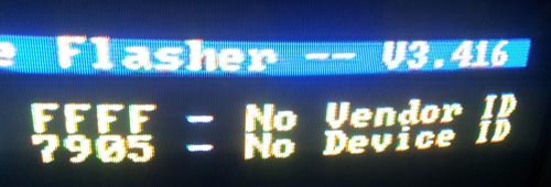

    @cafealpha2, just letting you know I just burned your latest flasher utility iso and it still tells me the same thing as last time when trying to flash the Gameshark (unrecognized flash chips etc.)

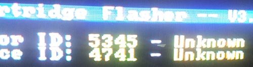

    And I could test 2 cards:
    - ST-Key (the gray one that in the screen says 1.0).
    - Magic Card V2
    both cards had the same result

    5345/4741 IDs (=SEGA in ASCII) a mechanical problem : cartridge is probably not correctly inserted.
    Can you flash your cartridge by using other flash utility ?
    Or, maybe the cartridge is read-only ? I don't know, because I never could see the inside of ST-Key / Magic Card V2.
    BTW, can you wait a couple of months before flashing your cartridges ?
    Before flashing them, I would be glad if you could dump their firmwares :)

    Ok I understand now, so basically it's because the Gameshark is not inserted just right.
    Yes, zorlon's Pseudo flasher disc works for flashing to Pseudo and back to Gameshark 1.96.
    I will try again and see if I can get your flasher disc to recognize the cart. Thanks for clarifying!

    Let me explain What i did:
    About the Magic card v2, I have sure it was connected, once I use it to boot your disc.
    And I could not be able to do the swap disk with the ST-KEY inserted as zorlon said. So, I inserted the card after your disc was loaded.
    As you said, maybe the card wasn´t inserted correctly. So I tried again to have sure.
    The first try, I have the same result. But the secont try I got something different
    strange.. isn´t it? Maybe I would have another result with a modchip, once I could boot your disc with the card inserted.
    Maybe, next week I can test using a system disc (lets say thank you to my post office for the delay). I will let you know.
    And I am afraid that I can´t dump these cards, once I don´t know how or even have a specific hardware to do that. But I don´t mind to share if was possible.

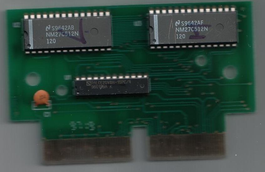

    scan/photo of st-key (ss-239)
