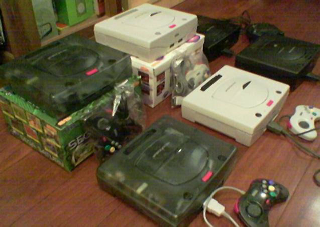

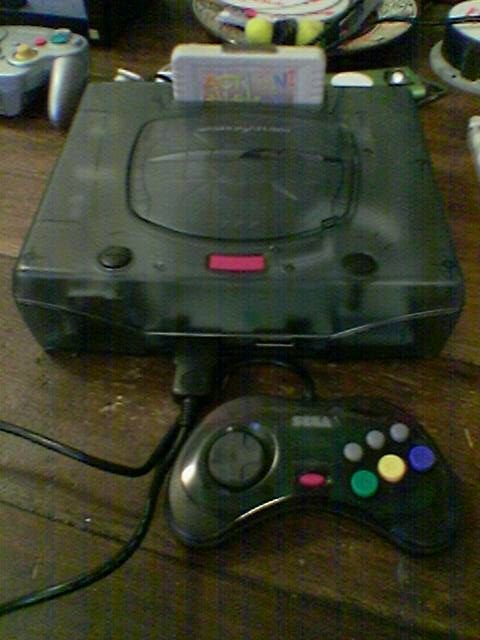

    Hi again Ya'll, just wanted to share my experience. It started out as extremely frustrating but in the end paid off. For those of you going the Atlus cdrom route to reflash your 5 in 1 carts, be patient and stick with it. It took me about 30 minutes of trial and error to get through the menus and figure out what I was doing. At first I successfully flashed to 202c (purely on accident), then got it flashed to 202 (after trying 50 times with write errors). When I had the cart flashed to 202c, it still wouldn't let me flash to the latest version of Pseudo 831. I tried everything but it kept giving me errors about the vendor ID and vendor DEV being unknown. Finally I did get the 5 in 1 flashed to 202 via Atlus cdrom, then loaded up the Pseudo 831 disc and it let me flash my cart, finally! I can confirm everything is working as the boys on the forum have stated and it boots up whatever your gaming heart desires.
    It only took 15 years to get this scheme figured out but it was worth the wait. Thanks for all the hard work boys!
    I've been in Saturn modding and hardware repair for a long time. My collection thanks all of you who worked so hard on this project :)

    By the way, does anyone have a running compat list for Pseudo .831? I've got a few hundred games here I can test and add to the list.
