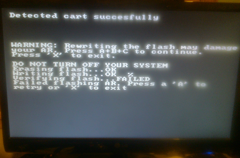

    So I managed to boot the Atlas flasher and flash my AR Plus 3 in 1 that I got from play-asia just fine, but I can't seem to get it to boot my backups. It sounds like it's struggling to read the disk (humming, starting and stopping). Then it just cuts to the CD menu. The vendor information wasn't listed on the screen where I flashed it like another cart I saw. Bad flash perhaps? Edit: I am still able to flash back to the AR Plus firmwares using the Atlas Disc, but cafealpha2's flasher will not even attempt to flash it due to an unrecognized device and vendor id (both display as just hex values instead of the vendor name). Final Edit: Got it to work! I had converted the mp3 file bundled with the Atlas disc to wav manually and edited the .cue this must have caused some sort of problem. I simply got a new Atlas disc without modifying anything and passed the .cue off to the software for burning and had the new disc work perfectly.

    That was really, it! I think I was actually burning it fine. It suddenly stopped working so I nudged the cart a little and got it working again. cafealpha2's flasher wasn't even recognizing the cart, I believe.

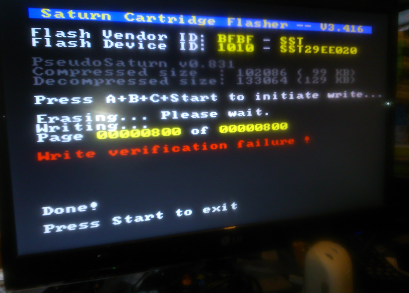

    I have a bios-modded region free saturn with a modchip installed, but thought I'd try this anyway as I know some friends who cannot get hold of saturn modchips as Racketboy no longer stocks them. So far using the OP's installer fails on my "Action Replay 4M Plus" (this cart doesn't have the commlink port, and when you open it up, you'll see it is much thinner so lacks the ability to solder one on). I used the 'retry' option, it always fails on flash verification. I've uploaded a screenshot, as well as a photo of the PCB inside the cartridge. May be handy for information on the flash chips used *shrugs*

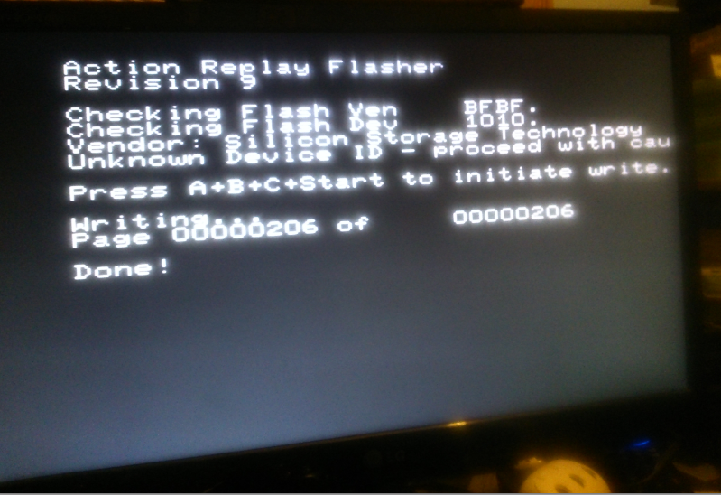

    Of course this AR no longer works at all after all this. I've tried cafealpha2's flash utility but got the same error: verification fails. Though I rather like the CEEFAX style graphics I will admit.
    Unsure what to do to revive this cartridge, I tried flashing the "Action Replay (PLUS) V2.02" and lower versions, all came up with write verification failure.

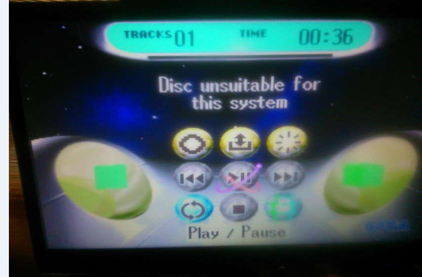

    I needed to edit the image to add the Pseudo Saturn firmware to it, so I did so using PowerISO. PowerISO refused to overwrite as the image is MDF, so I saved a new image. Only, when I played it on the Saturn, I got "Disc unsuitable for this system".
    WHAT? My Saturn has a region-free bios, that error message is not meant to appear ever! Eventually after a lot of hair loss I discovered that when saving as a new image from scratch, the headers are messed up, and the bios won't recognize the resulting CD as a Saturn application. Even if you use Saturn Region Patcher, it won't work. So I downloaded the whole "The Rockin-B Allstars" image which is based on Atlas http://cloudstor.es/f/gnw/ and was pleased to find it was a direct ISO file already. Edited the image to add the Pseudo Saturn firmware file and burned. But, the Saturn only recognized the resulting CD as a music CD. Damn! Tried opening it with Saturn Region Patcher, only to be told it's not a valid Saturn image. Eventually actually bothered to read how Atlas works. Basically you have to use the CD Image creator from the Rockin-B website and put the firmware file in place before running a batch script. FINALLY a CD that boots, FINALLY I can open the SaveGameManager application, and attempt a flash again. SUCCESS!

    I believe that's the error that I had. Try raising the cart 1-2mm, as I finally realized that was the problem I was having.
