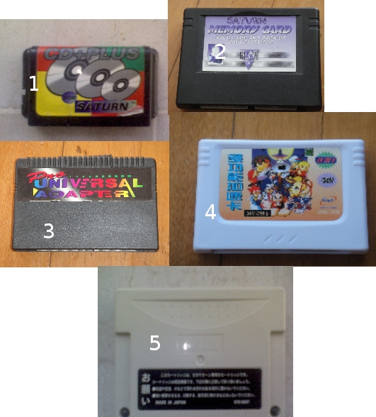

    Just wanted to say "Good job" to everyone involved. This really helps keeping one's Saturn intact and still be able to play backups. Prices are going crazy indeed. I am hoping to install it on my Action Replay 4 in 1 Plus very soon, i have a friend who keeps several cartridges, if anyone by any chance thinks that one of them will work it would be great, since he also has an unmodified saturn. Sorry if the pictures don't look good and all, it's how he send them to me ! I guess that the import only carts are ruled out from now.

    Well, 1 and 3 are import adapters and won't work, as you suspected. 2 is for backing up saves from the internal memory and won't work. #4 is a RAM cart and - you guessed it - won't work. I don't recognize #5.
    Edit: Found some info on #5. It's just another memory cart, like #2. Time to buy another Action Replay!

    Well, that's what I thought when i saw the carts as well, but since i'm no Saturn expert, i figured I should ask first. At least I've got the Action Replay 4 in 1 Plus, so we might share that one (if the flashing goes ok, which I hope it will !) until he finds a decent action replay cart, thanks for the heads up !
