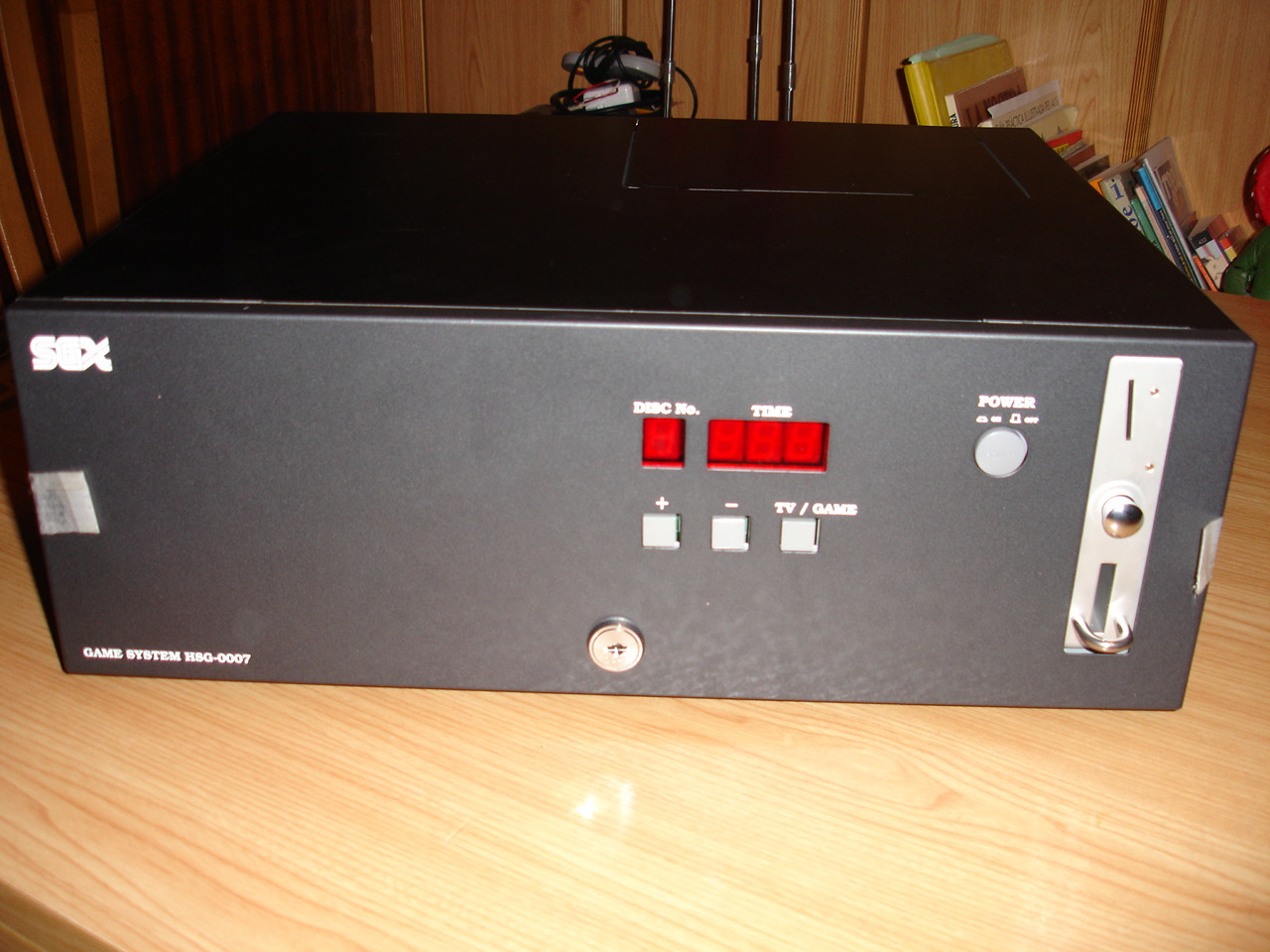

    The HI Saturns were okay, but the serious collector wants the SGX-0007 coin-op hotel Saturn. You just have to clean off the spooge :(

    Woah!! that's yours dude?! Nice :) how'd ya get it? I know, from Japanese Hotels but i'm pretty sure you've paid thousands for it i bet. lol

    Not mine! Just snagged that pic off the internets :) I wouldn't mind having one but I think they go for a pretty penny :(

    oh wow! i thought that was yours for a sec, lolz!!

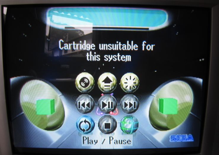

    @ Druid, this is the reason I'm asking. I'm out in the workshop digging through the old Saturn misc and I found 2 - V13 mobos that some idiot ruined trying to do a region mod. If in fact the 4 in 1 w/ Pseudo on it can bypass these jumpers, these 2 units should work:
    http://i.imgur.com/8FhPsKZ.jpg
    http://i.imgur.com/jLtfLWN.jpg
    If you need any parts lemme know because I have boxes full of misc. I'll let you know the results as soon as I put one of these back together.

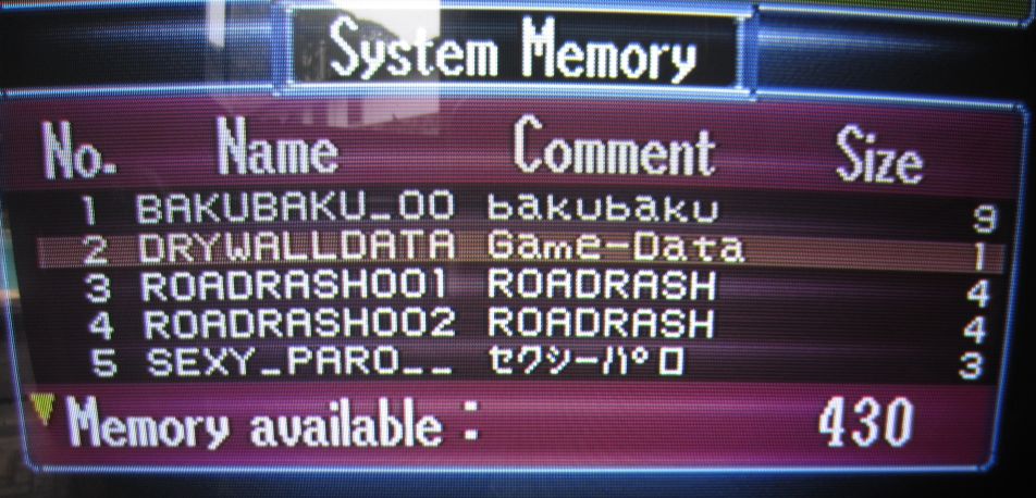

    Well here's an interesting conundrum. When you flash Pseudo on your Action Replay, is it also writing a piece of data to the system memory? This screenshot would indicate so. I managed to put together another Saturn and it's giving me the "cartridge unsuitable for this system" error. When I put the AR back in my Skeleton, it boots Pseudo no problem.
    Saturn I just threw together with empty system memory:
    My Skeleton model I originally flashed Pseudo on:
    This "game" doesn't exist. Is this piece of data written to the system memory when you flash your AR? If so, this little piece of data needs to reside on whichever Saturn you are using with Pseudo, correct?
    Any information is appreciated, thanks!

    That has to do with the region flags on the cartridge ROM. The saturn obeys the flags and ONLY ever show that message if it's set to a region which the cartridge does not have a flag to.
    Only three or four region flags out of maybe 8 or 10 were used. And the BIOS do honor all flags. So check the region jumpers on that Saturn.
    DRYWALLDATA is from some U.S. DISC. I don't remember which. Maybe that weird GENERATOR demo disc ?
