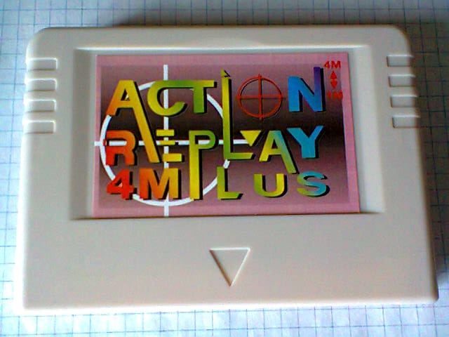

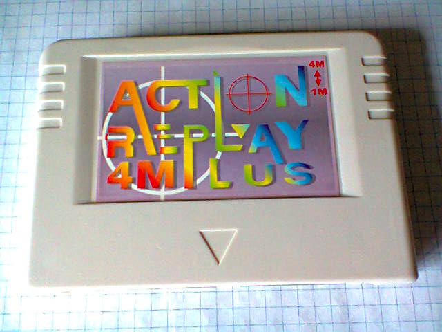

  18. ynoS XSP
    ynoS XSP Rapidly Rising Member
    Jul 26, 2015
    93

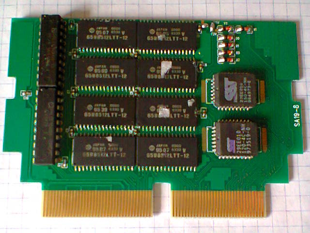

    Well people, here it is, it arrived yesterday:
    I have already tried Pesudo and, at first, I got the same results as nonosto did:
    Flash Vendor ID: BF45 - unknown
    Flash device ID: 0741 - unknown
    I used CafeAlpha's installer disc and decided to proceed with the flashing. It terminated successfully. Yay! :)
    So yes, the cart is compatible with Pseudo but I did notice that no matter what type of disc I used (retail or back-up) I always got the message "real Saturn disc detected", which obviously isn't true in the second case.
    I know I really should not be complaining about anything, since Pseudo is free and works ;), but is this a bug or the result of some cartridge/Saturn combination? o_O

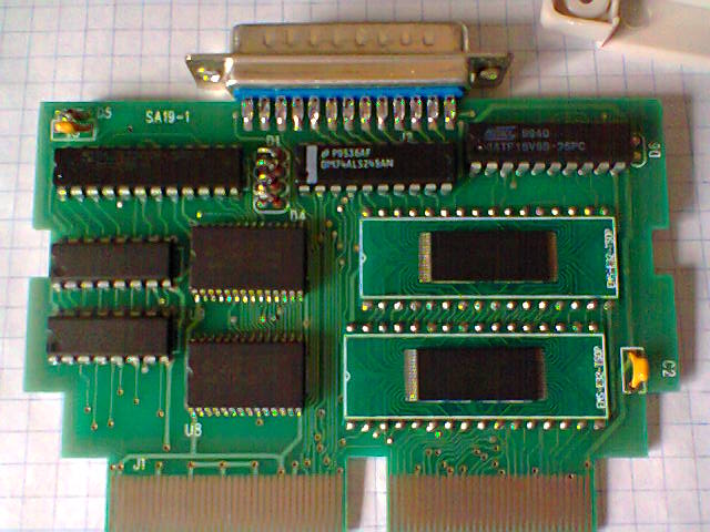

    Meanwhile, I managed to get my hands on an older version of the ARPlus (with the comms port) and I decided to do a comparison test:
    This time it reads:
    Flash Vendor ID: B7BF - SST
    Flash device ID: 0707 - SST29E010
    Again, I used CafeAlpha's installer disc and it flashed flawlessly.
    But the same 'real saturn disc' bug appears. :confused:
    What could this mean? o_O
