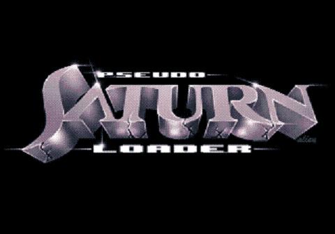

    Worked for me :), but only on my older model AR plus with the comms port...
    The newer one, which I recently bought from EMS, reports the same "Error dectecting cart.HW not supported." as described above.
    It features a nice logo on boot and supposedly is more compatible, which I can confirm to some extent since my copy of Batsugun crashed with 0.831 but loads fine with 0.832.
    It also shows some additional information on screen, like cd region, but everything disappears so fast it's hard to make out.
