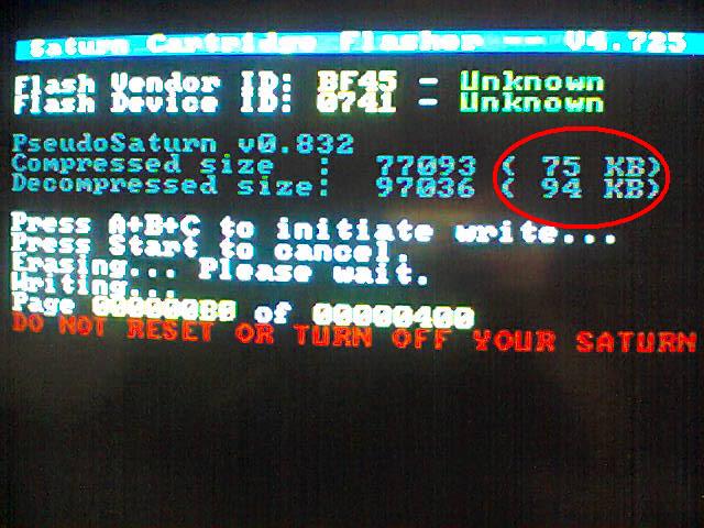

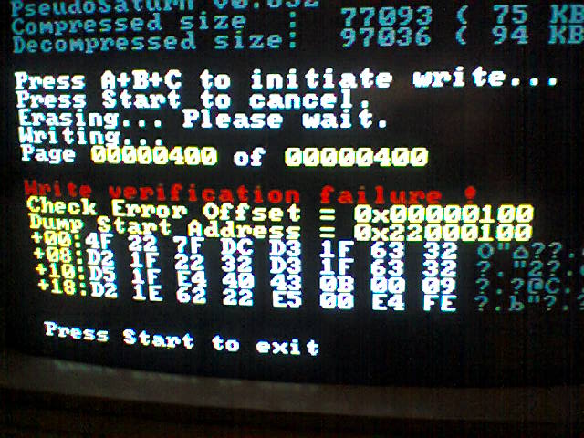

    Unexpectedly, I am getting an error message when trying to flash the firmaware with Pseudo version 0.832...
    Has this happened to anyone else?

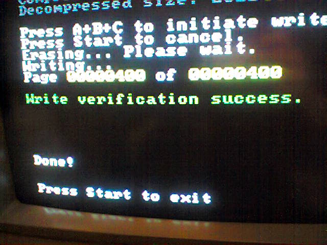

    But this only happens with 0.832 with logo, if I chose 0.832 without the logo it terminates with write success.
    I did notice that version 0.832 with logo has different decompressed size, is this normal?
    Should it not be the other way round, I mean, without logo version with less size? :confused:

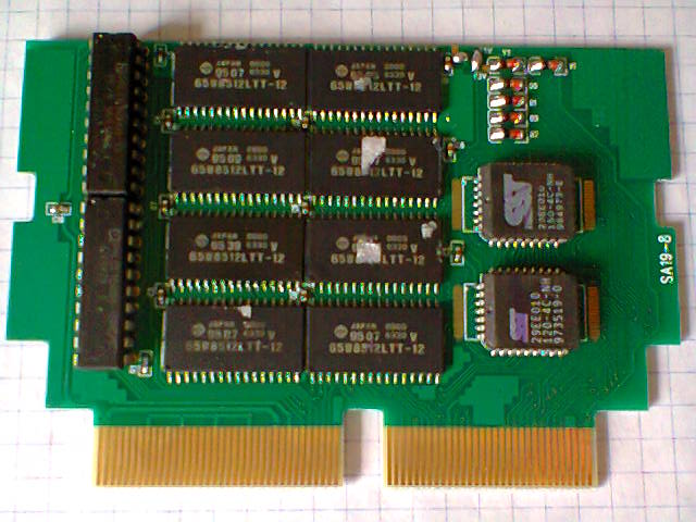

    I am using a recently acquired AR Plus (4M) purchased from EMS:
    It reports back:
    Flash Vendor ID: BF45 - unknown (but in green color)
    Flash device ID: 0741 - unknown (but in green color)
    Yes, the version with no logo flashes and boots fine, which is kind of weird. :confused:
    Even weirder is that after a failed flashing Flash Vendor ID and Flash device ID changes (different number or letters) and color changes to yellow !? :eek:o_O
    I thought this had to do with bad connections or improper seating of the cartridge but no.
    Only if I flash again with some firmware that works (0.832 no-logo or ARP 2.02C) the IDs return to "normal".:confused:
  17. cafealpha2
    cafealpha2 Site Supporter 2015
    Jul 4, 2014
    280
    That's weird, can you reproduce this bug or does it happens randomly ?
    Please try to slightly move your cartridge in its connector when firmware selection menu is being displayed. If detected as BF45/0741, there are chances (not 100% accurate however) that the cartridge can be flashed.
    Please retry to reflash your cart :) As logo version was reported working by other members (Thank you Zorlon :) ), I suppose your problem is hardware/connection related.
    That's "normal".
    No logo version is resized to 256KB and unused space is padded with 0x00 bytes while logo version is raw binary output from compiler.
    I suppose no logo version file was resized by yabause ? I don't plan to trim this file, because it was reported working as-is, and since firmwares are compressed in flasher binary, padding bytes doesn't waste so much space.
    BTW, no logo firmware real size is around 71KB, vs around 95KB for logo version.
    It's amazing to see how many PCB variations there are for Action Replay carts.
    As you can see on PCB picture, Flash chips (SST chips on right side) are different, so I suppose one is standard (detected as BF/07) while the other one isn't detected (counterfeit ?) and flasher see its IDs as 45/41 (= E and G letters from SEGA string at the beginning of flash memory).

    After the failed flashing I had to flash back to ARP 2.02C firmware to get flasher utility recognize card correctly and then flash again to 0.832 no-logo version and it worked.
    At least it didn't brick the cartridge, and I have not tried again since that event.
