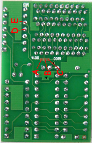

    I've just begun my journey into the modding world, I'm a big Sega collector and clearly a chipped Saturn was required!
    I have a model 2, and I successfully installed a Universal chip, it worked fine for a few months. However, recently it wasn't reading disks.
    It would read them as CDs, but not games, so I re-bridged the A and B bridge and it works almost perfectly again.
    The problem i'm currently addressing, aside from an "ify" disk read, is the video output, for some reason when the console loads from the disk, the screen becomes distorted and has some colored "fizz" is you will :)
    This ONLY happens when it's loading, and happens to both NTSC and NTSJ games (I thought it may have been an issue with imports, but no dice!)
    I'm assuming it's a problem with the ribbon cables... but before I do anything I'd really appreciate a more experienced opinion, and maybe a little pointing in the right direction?
    Thanks so much in advance! --Mike

    EDIT: Checked again, it doesn't do it with the original ribbon only, so it could be either the chip or second ribbon...
    Here's a video if it helps... thanks! https://www.youtube.com/watch?v=3iX_05f8oCU

    Thanks :D I'll try that later tonight, but I was under the impression it wouldn't read the disk if that was the case... Is the bridge really only for video output?
    Just to make sure, for my model Saturn I'm supposed to bridge points A and B correct?
    Just making sure, considering i'll be doing it again anyway :p
