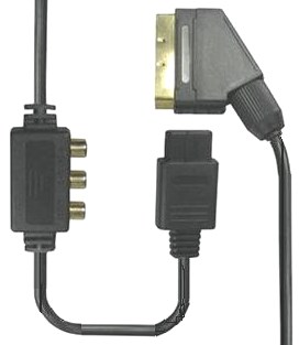

    I just got the SD2SNES and it's fantastic but I'm having one issue that's becoming a real problem. The video will randomly crap out and it requires a hard reset before it'll work again. This happens in the menu, during games, whenever, and there's no pattern to it. It doesn't just go dark. The screen will scratch out for a second, pretty much resembling the effect of switching your computer to a resolution your monitor doesn't support, before going completely dark. All sound cuts out, too.
    I do have a somewhat unusual set up. It's an authentic unmodded SNES but I'm using an SCART cable to an SCART/Component converter so I can plug it into a monitor that doesn't have standard definition inputs. It's definitely the SD2SNES causing the problem since my normal carts have worked fine and I've already had this happen at least a dozen times after using the SD2SNES for only a few hours. It's the same issue on both firmware 1.3 and 1.4pre4.

    Yes and no. The audio is coming from the same wire but the converter doesn't support it. The SCART cable has an audio block on it like so:
    This is the converter:
    http://www.ebay.com/itm/SEGA-SCART-RGB-YPbPr-YUV-Component-Video-Converter-/220698773448
    I can try a few more things but the fact that it's random makes it hard to pin down. I'll fire up a game and it might happen within 20 seconds. I'll hard reset, restart the game, and play for 20 minutes. I'm sure it has something to do with the connection but the fact that normal SNES carts have never given me this problem before tells me that it's not just a general problem separate from the SD2SNES.
    I will say that I've noticed that when it does happen it tends to most often be upon me making some kind of move, like opening a folder in the menu or switching screens in a game (like pushing start on title screen). It happened right after I pushed start on the pendulum screen in Chrono Trigger one time. But that hasn't been consistent either. It happened at least once while I was in the middle of the first level in Mega Man X3. And then after restarting I got through half the game trying to reproduce it to no avail.
    EDIT: I plugged the audio into an external soundbar bypassing the monitor completely and now have a better understanding of what's going on. I played through Mega Man X2 from beginning to end with no issues. Then I loaded Tales of Phantasia and it happened in the middle of the intro during the cast roll call. This was actually a great time for it to happen since it let me get a grasp on a number of things.
    First, the sound did not cut out. But it did hiccup despite the audio not being connected to the monitor at all. The vocal song started to skip when the video cut out (think what happens when you alt+tab a running emulator) but then continued normally after the screen went black. The controller functioned normally. I was able to go to the main menu and start a new game despite having no video. Turning the monitor on and off does not fix it.
    I'm drawing RGB from the console and converting it to component. When this weirdness happens, the effect (based on my observation) is kinda like the SD2SNES is trying to alter something in the signal whenever it feels like it and the converter and/or monitor doesn't know how to process the change. Why the audio would be affected at all though, I have no idea.
