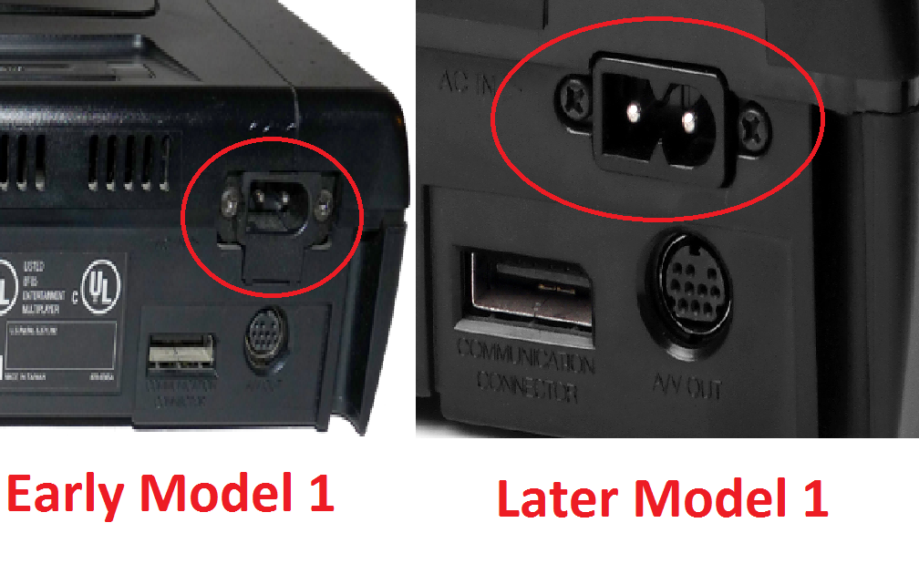

  4. Zer0-2k11
    Jul 18, 2012
    542
    Here is some info for anybody interested in looking to get the right bios for their Saturn without opening up your Saturn. For model 1 Saturn's, you can identify which type you need just by looking at the power port (See pic below). For Model 2's they are all SMD.
    Early Model 1 Saturns (DIP Bios) Vs. Later Model 1 Saturns (SMD Bios)
