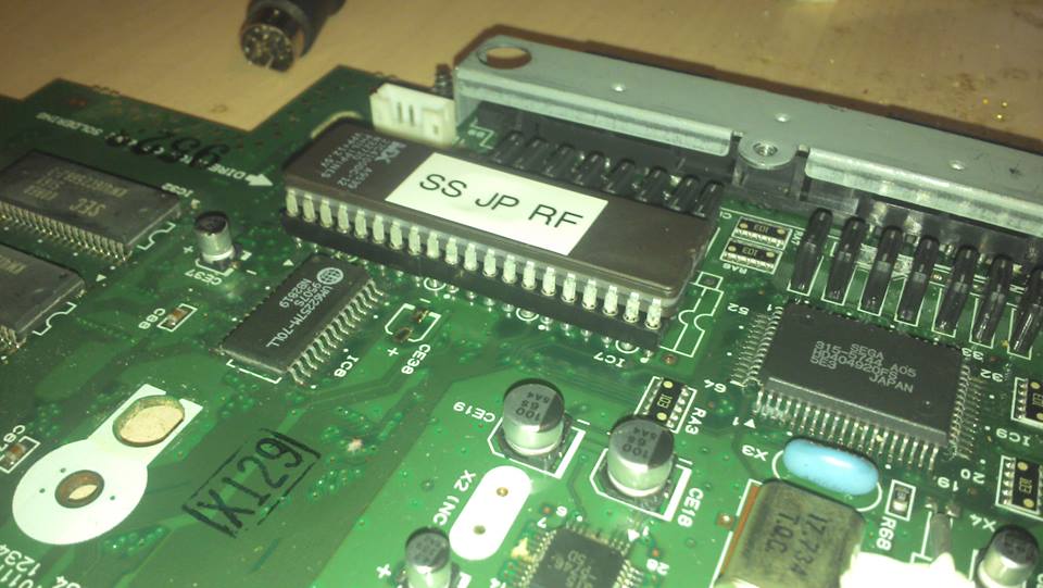

    iddod Newly Registered
    Dec 26, 2012
    got my saturn bios chip through the post this morning, cheers Adam, within 2 hours it was installed and working perfectly...
    my saturn is a PAL model 1, VA0, with rev B laser unit and 40 pin DIP bios...
    i knocked up a 40 pin DIP socket using a pair of 28 pin sockets and a craft knife and soldered that into place, i figured this would make life easier if ever there's an update to the region free bios or if i wanna use one of the other bases for the bios (the one i bought was based on the Japanese bios), before i started i wasn't sure there'd be enough room under the shielding for a socketed chip but there was a good 2mm clearance after it was all installed and screwed back together...
    i documented the install with photos and they can be found here if anyone's interested... https://www.facebook.com/iddod/media_set?set=a.10154216513625224.1073741832.559440223&type=3
    but because i was looking for a picture to confirm that the RF bios was a direct drop in replacement, and couldn't find one, here's a pic of that, in case anyone else is looking for the same thing :D
