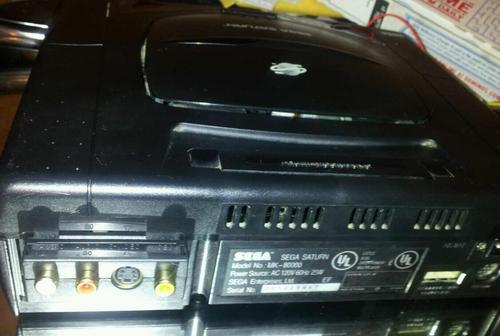

    Check this page: http://www.gamesx.com/avpinouts/saturnav.htm
    Pins 9 and 10 are for s-video. What this thing does is basically tap off the pins in the A/V port and send them to the plate with the standard plugs in them. Notice how the listings says "requires soldering". That's because you need to solder the wires from the added plate to the pins on the A/V connector for the proper signals. Looks to be s-video, composite, and stereo audio. 6 wires more than likely.

    Is there still room to change the battery or use a VCD card with this? Just curious. If I got any video mod, it'd likely be component. At the moment have an RGB cable.

    okay makes sense. so would you do something like this? should i pull the trigger? its really cheap but i dont want to miss up my saturns i just got them. but as a plus side im very handy with a soldering iron. im in the middle right now

    Not sure since my Saturn is in storage ATM. If I were to do something like this, I'd move the battery to another location and put a rechargeable one in. Also put in a good VCD card so I never have to worry about that again.
    The real question here is this: is it worth it? All this does is eliminate the need for the official cables. If this thing + s-video cable + audio cable is cheaper than an official s-video cable then I'd say go for it. Who knows, you might even get a better picture if you use one of those high quality s-video cables with it.

    + time it takes to solder it in. + risk of lifting pads and killing the console due to being a cheapskate over the $5 price difference.
    Id say not.
