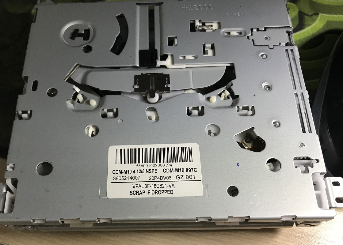

    The biggest problem with slot loaders is that they are about the most unreliable type of cd mech there is. This is pretty much to be expected from a complex mechanism like that which has been designed to be as cheap as possible and mostly implemented out of stamped mild steel and plastic moldings.
    They are also extremely fragile - even damage that leaves no visible signs can leave them in a state where they are no longer capable of operating reliably. I think it's nicely summed up by the "SCRAP IF DROPPED" label on this one.

    Ha! Yeah, I've had a few where the drives have literally just fallen apart, but they were sold as faulty so I expected it. It's the one reason why I'd be wary of getting a working Q for myself; even if it works now, who knows how long it'll be before it almost inevitably self-destructs.
    Oh, I don't deny they're easily the most fragile design. I just prefer them.
