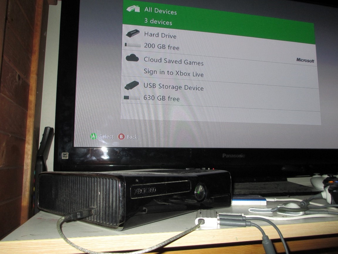

  4. SlickClick
    SlickClick Member
    Jul 15, 2015
    Here is my setup... I still have all the factory ports too; this mod adds a usb slot...
    I am using a usb hub but have read else where some one used a SD memory card reader...
