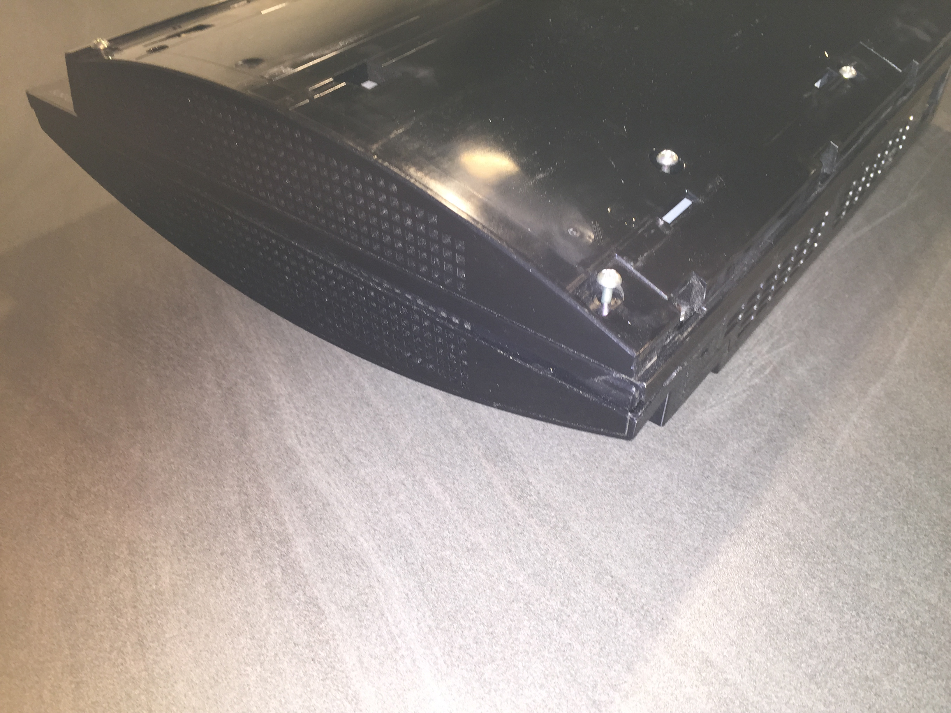

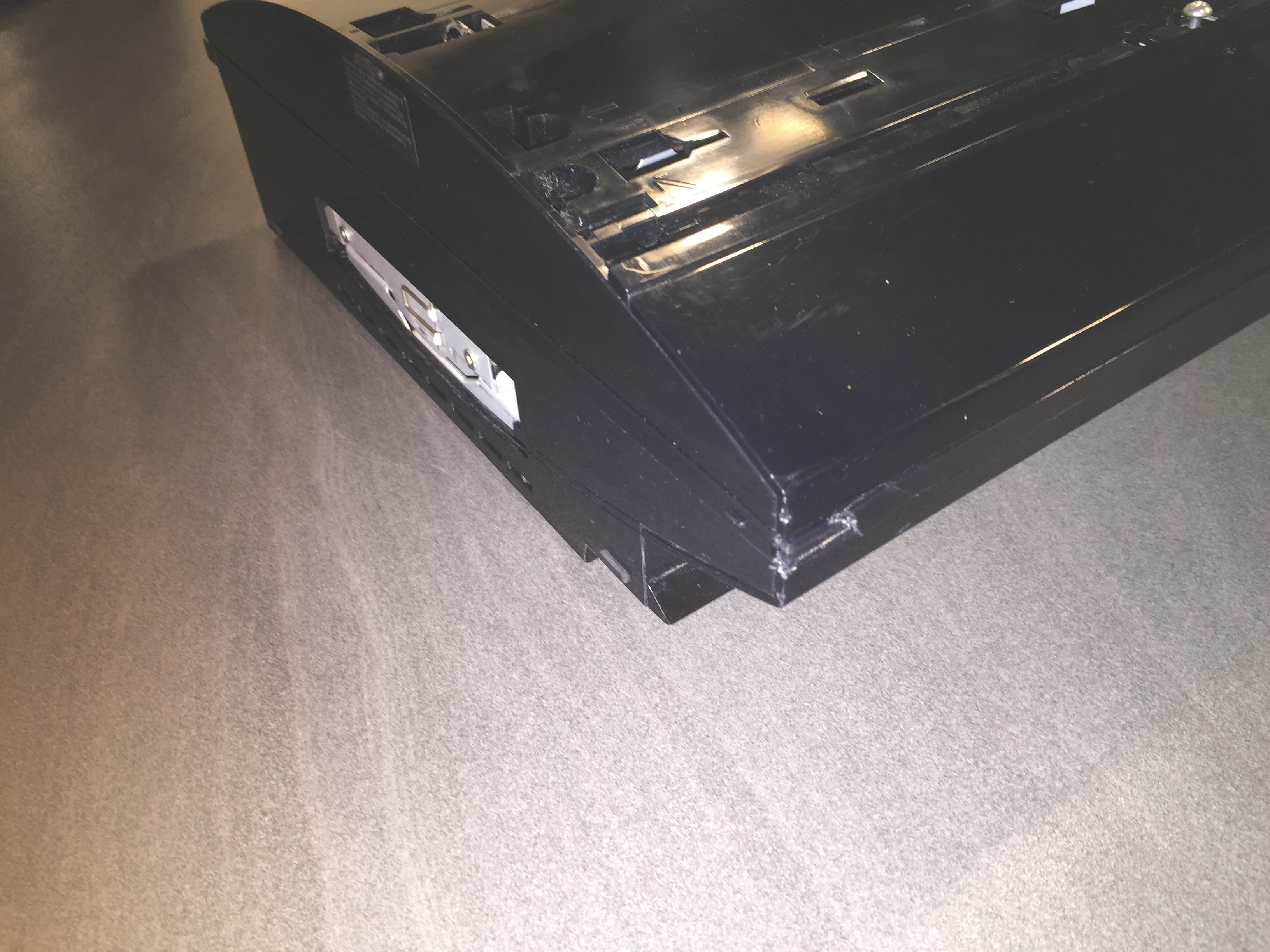

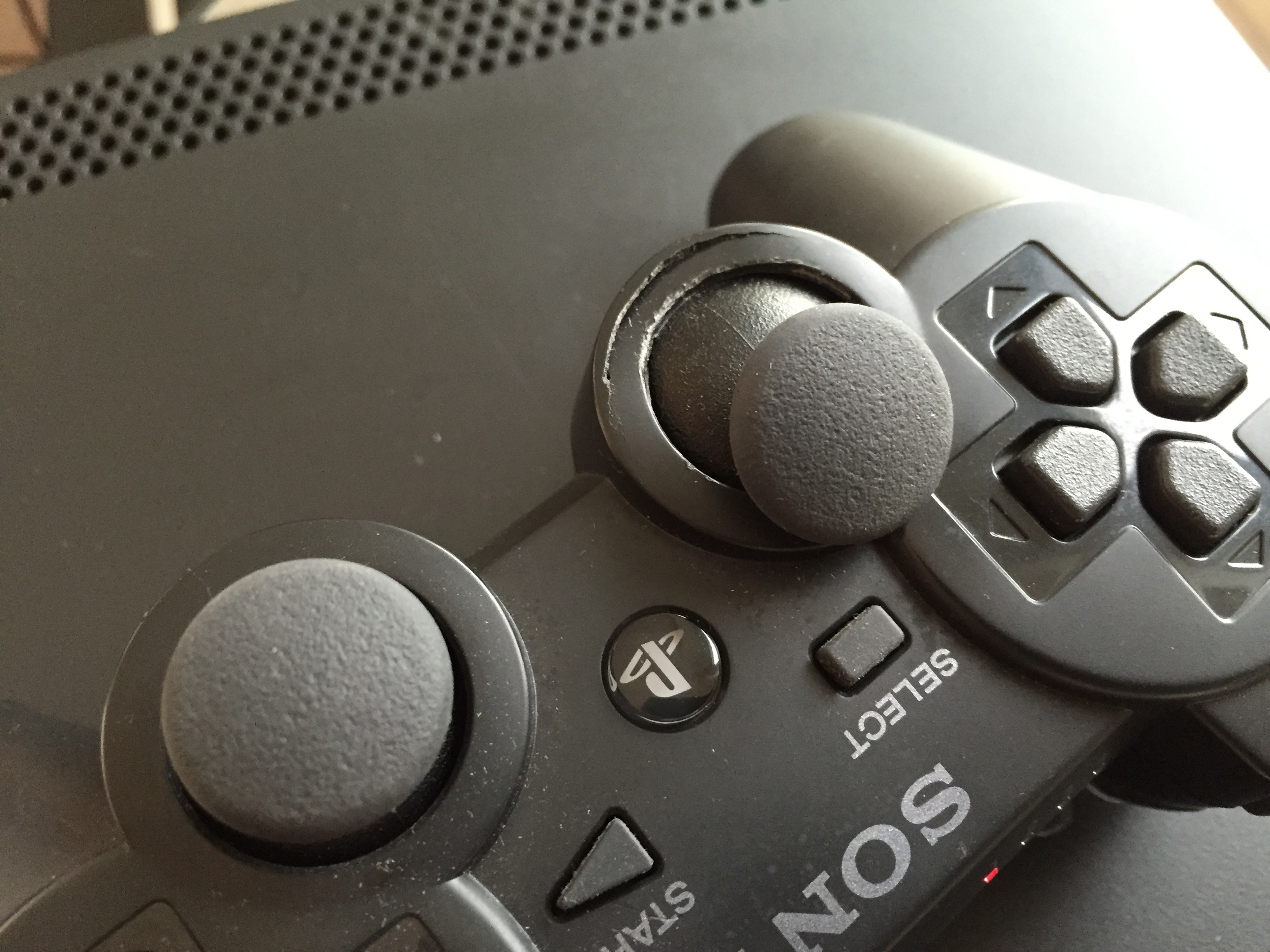

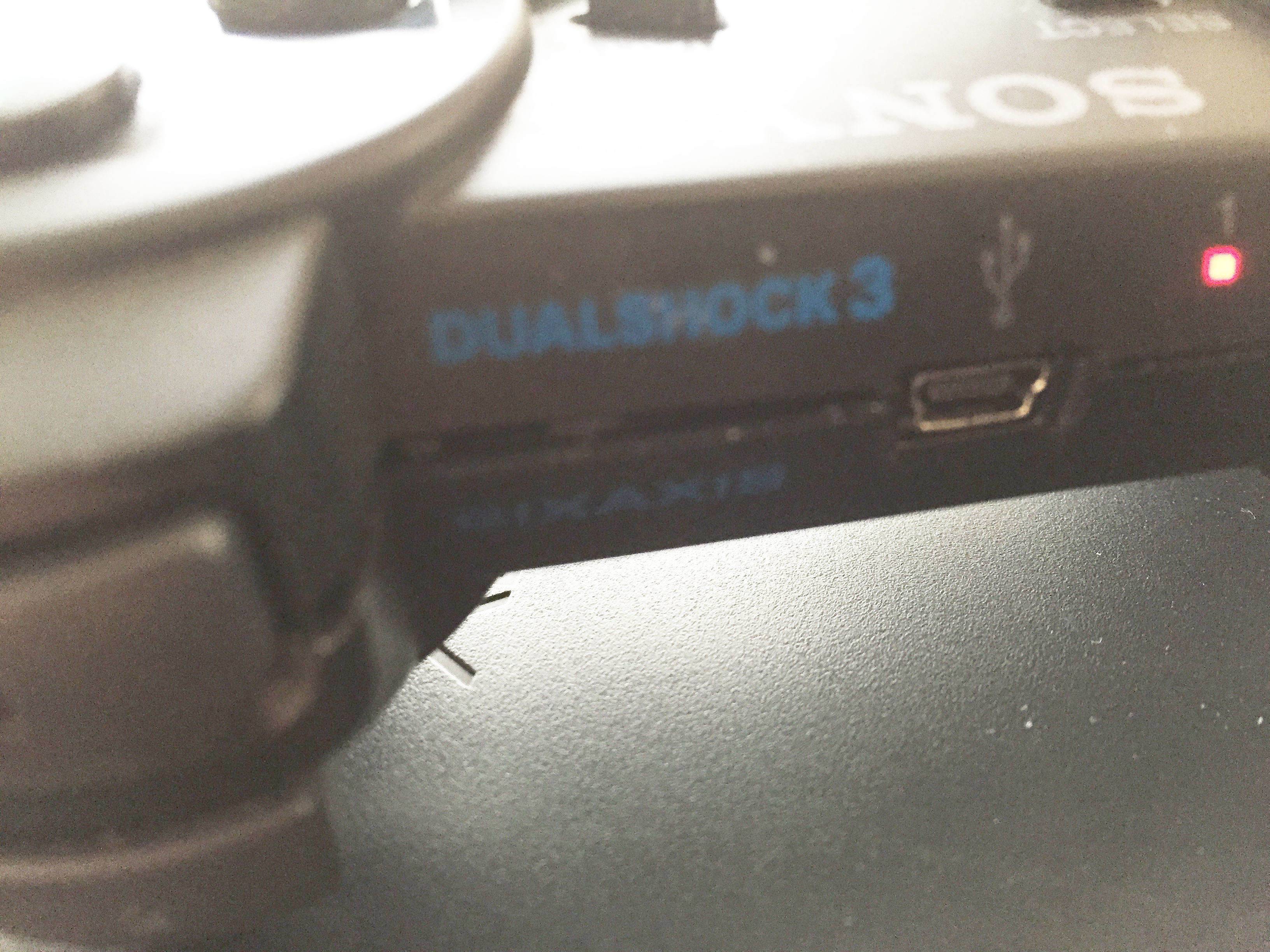

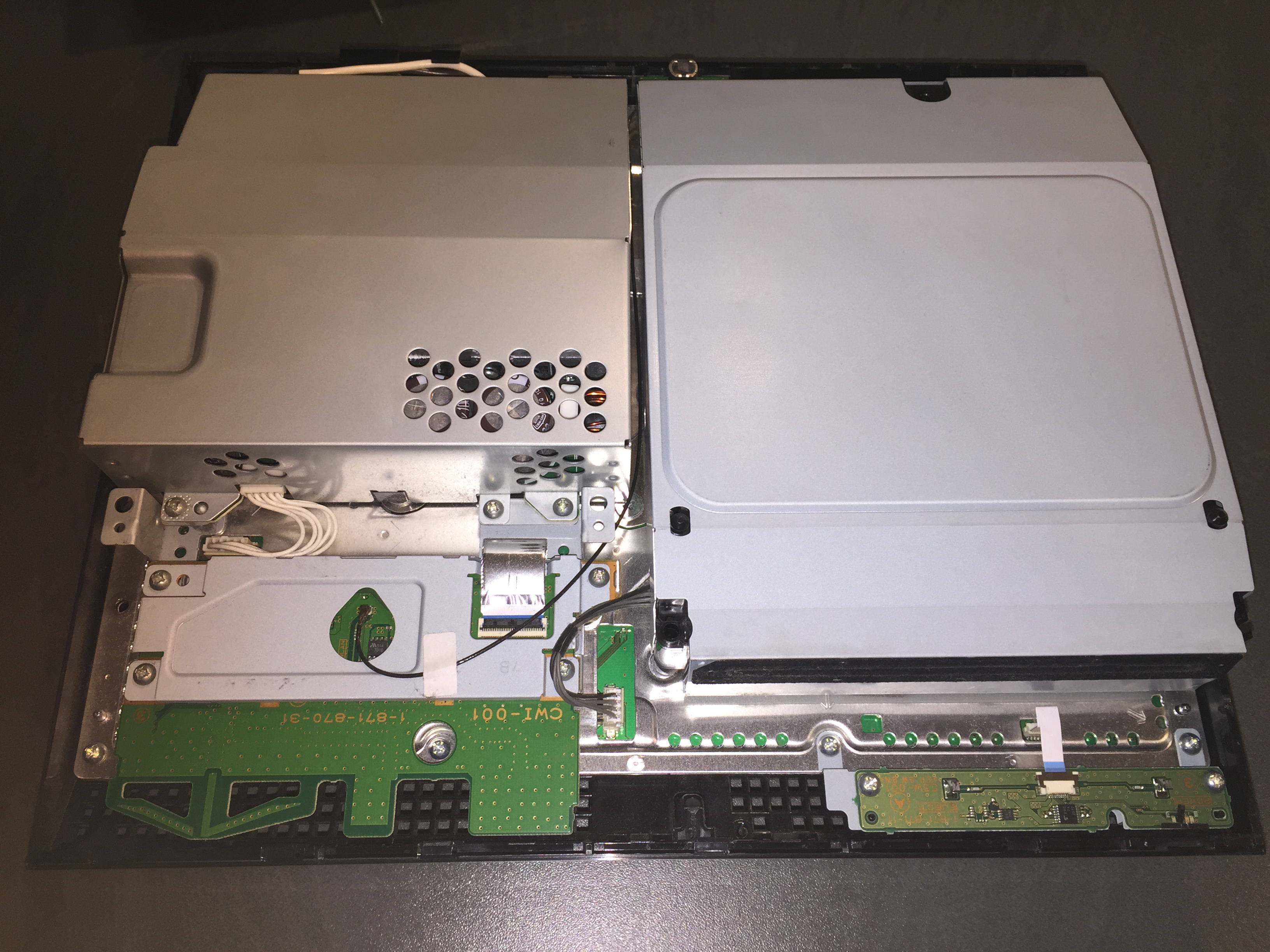

    I got my DECR-1400 yesterday along with a controller and some discs. The controller and the system had huge signs of trauma with cracks and distortions. Weirdly the discs was unharmed. Now the system may be f'ed but I refuse to just let this content go to waste.

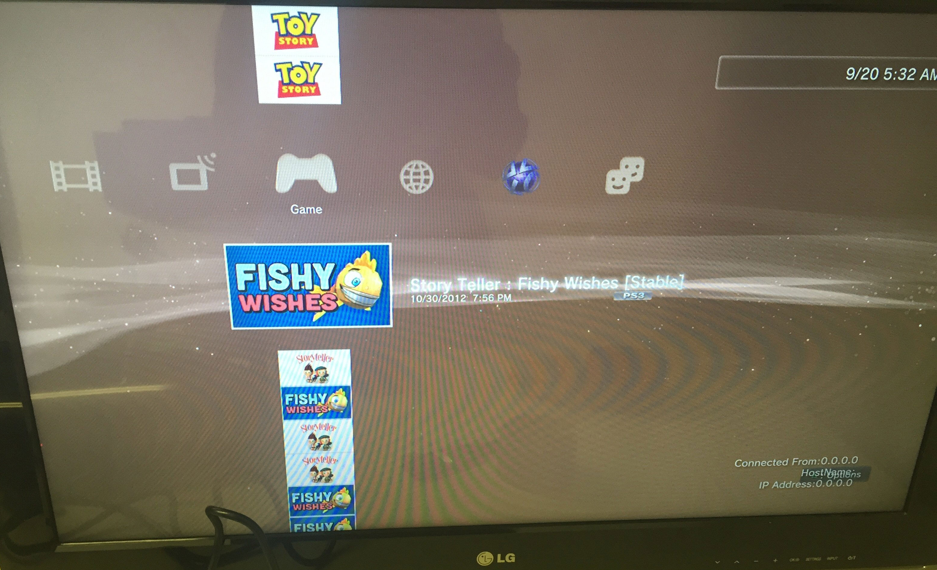

    Here is what is known about what was on it; in 2012 there was word of a PS3/Vita ebook platform called Storyteller, to be announced and shown on E3. Then nothing happened. No screenshots or info. Well this system holds a 1TB disk that according to the seller had a ton of games on it, among those are Storyteller, ToyStory, FishyWishy and more. The latter two are most likely Storyteller ebooks. This cannot go to waste!

    I tried opening it genlty yesterday and noticed what I believe you refer to as a ribbon cable(?) going from the BD-ROM and into some other parts of the console. If I lift the lid off then this cable needs to be removed somehow. I heard they are very fragile so I'm not keen on doing that, but I guess I have no choice. Are there no way to access the HDD content without the console?

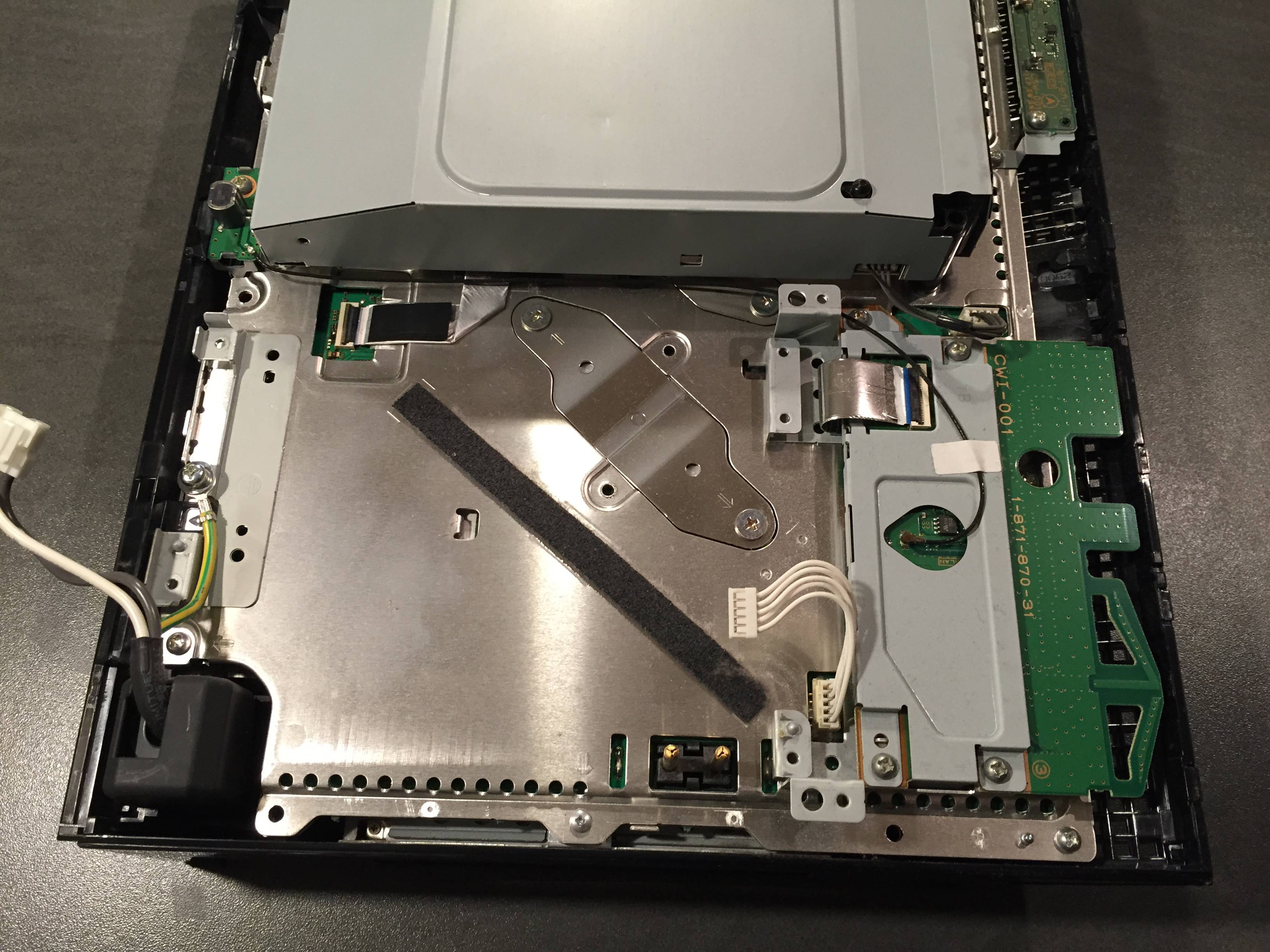

    Alright, then I just have to roll up my sleeves and get to work. No idea what to look for other than loose cables or whatnot. The pictures in my original post shows the unit somewhat disassembled. Anything in particular that I should check? The boot sequence is Green -> Yellow -> Red Blinking + 3 beeps. Don't know if that means something.
  13. Bad_Ad84
    1,309
    It could be that internal components have fell off the motherboard. Open it up, pictures as you go and look for anything out of place.

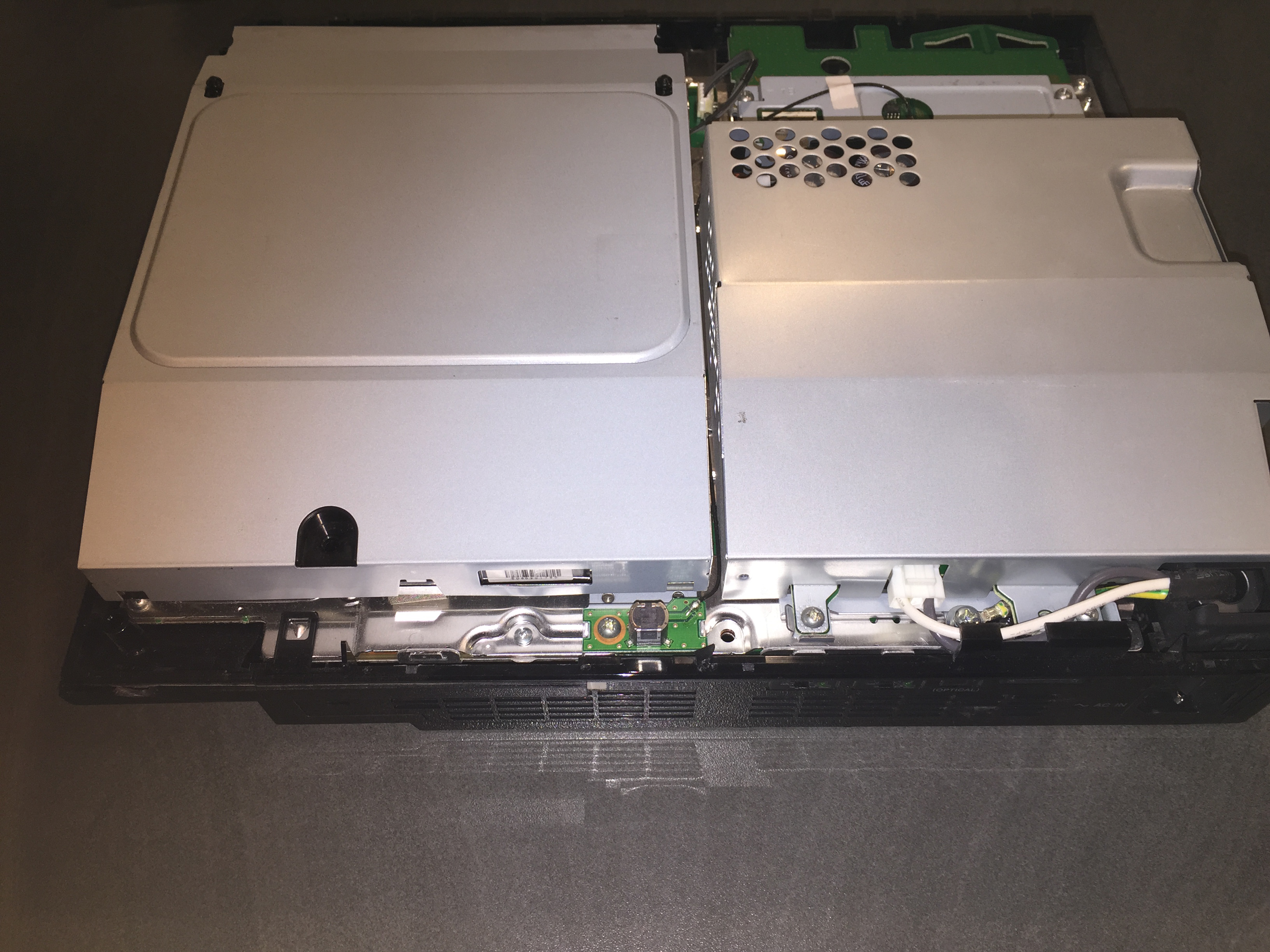

    Removed almost everything (except final cover for motherboard) and put it carefully back together again. Still YLOD. This is a needle in a haystack situation. What is the obvious next approach? Blast the mobo with a heatgun? Replace part X etc.?
  18. ProtonX
    ProtonX <B>Site Supporter 2014</B>
    Aug 31, 2010
    170
    38
    Honestly your best bet is finding someone online who specializes in fixing ps3s professionally. I used to have a local guy who specialized in reballing and diagnosing boards- but he stopped a few years ago.
    Even then... not to be the bad guy, the hard drive may have been damaged in the smash...
