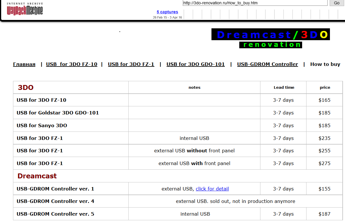

    I was all for buying one of these until I read more about how Mnemo handles his business. His pricing is getting insane, too. Weren't they like $160 only a few months ago? What other ODE device/flash cart has warranted a $230 price point? I mean, I get it, supply and demand and competition (although it appears Mnemo may be limiting the supply purposefully). I guess that's why I'll wait for some mass-produced Chinese clone to come through.
    http://www.ebay.com/itm/Sega-Dreamc...DEMU-BUNDLE-/162047932817?hash=item25bacf3991
    ^You've got to be kidding me (sell!). If people would stop buying these, Mnemo would be forced to reduce his price and may even have to resort to treating people with respect.

    I was one of the first to to order and receive a unit from MNEMO. I paid 243 shipped, via western union. So if anything MNEMO has lowered his price than what it was originally originally sold for. Seems like @superg price is lower and safer with paypal. If you don't like the price then just move on.

    This is what I was expecting to pay. Not sure how he has lowered his price. This is from January.
