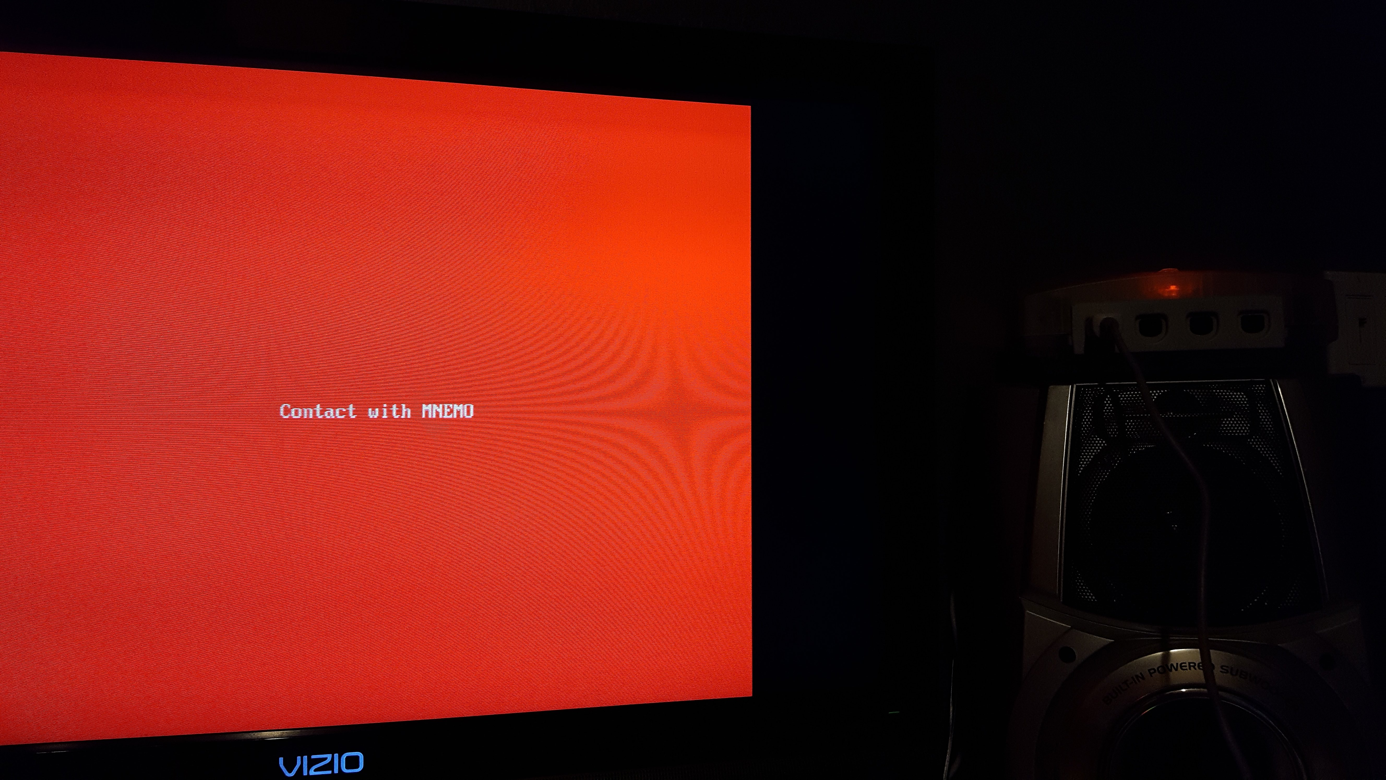

    I just got my Mnemo board yesterday. I tried to boot a GDI and encountered a red screen that says contact mnemo. CDI's run...kinda they have audio problems. Does anyone have any info? I contacted mnemo just no response yet.

    Never seen that before. Any chance of a photo and what firmware are you running?

    Here's a picture. I thought the board was supposed to work outside of the box =/
    Firmware version correction I thought Ithat was 16/04/26 but that's the menu version lol. I uploaded anot her picture of my menu screen, I have not flashed any firmware yet I tried and it booted as a cd disc...
