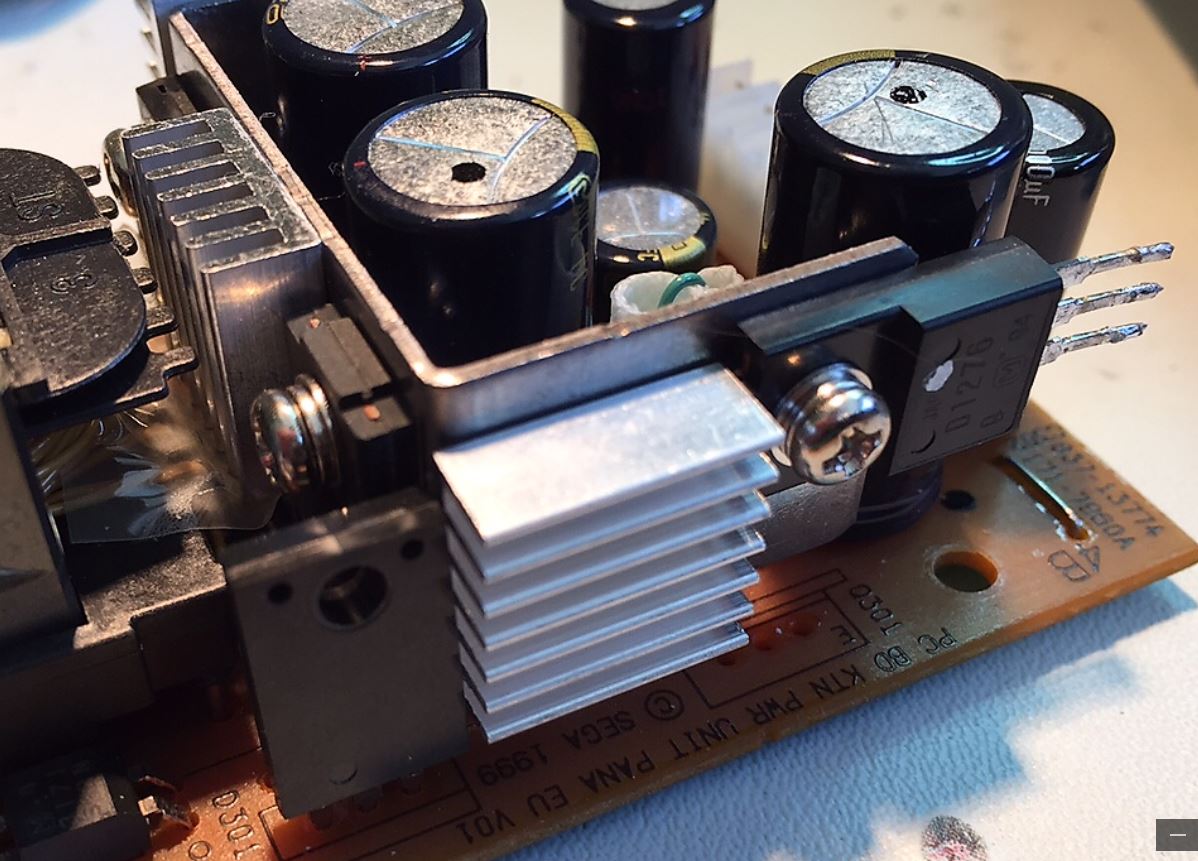

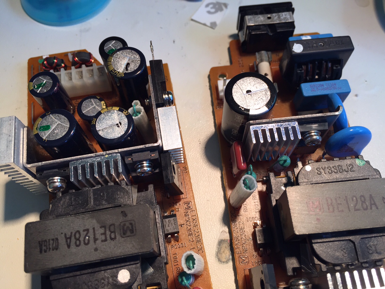

    The problem I'm having is that my PAL PSUs do not look anything like that.
    I've followed 12v to this point.
    I removed the whole part there and it looks good. +3.3 and +5v are both intact.
    Heat sinks still get too hot to touch after 10 minutes though. Must not have been right,

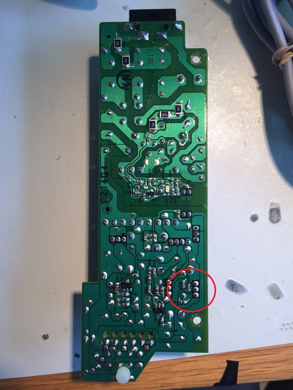

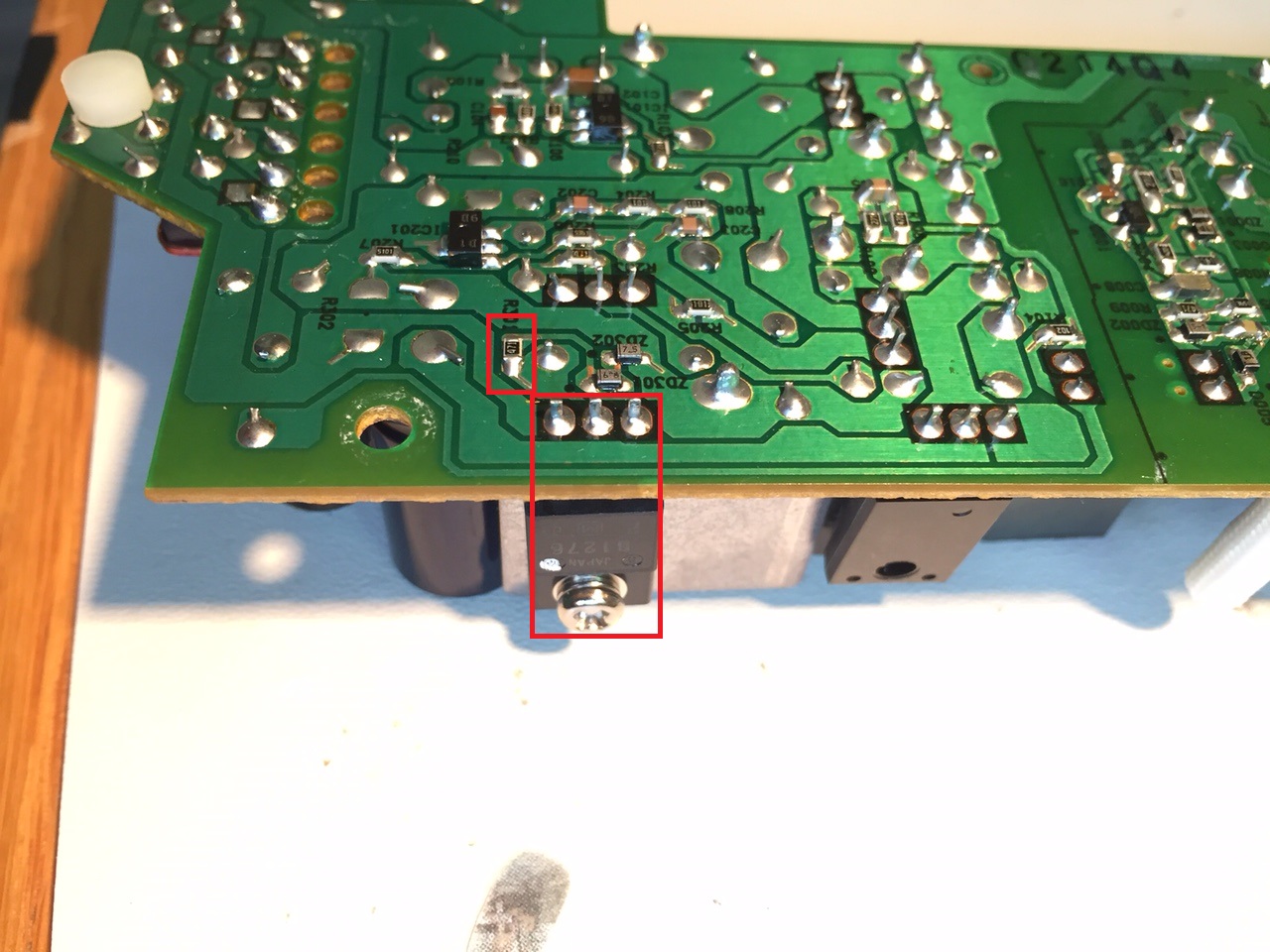

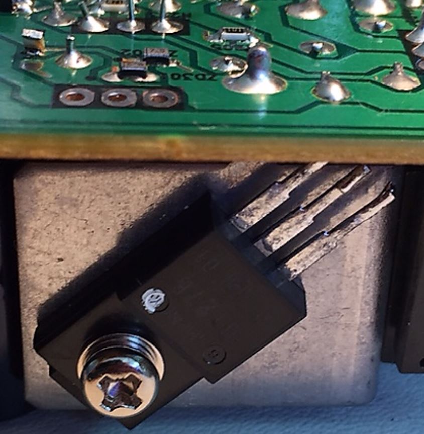

    So i removed the resistor as well. Not sure it helped. The heatsinks still get very hot but not as much as with the 12v connected.
    So here are some picture pr0n for you.
    If you have this one:
    You'll want to remove the parts in red.
    It should look like this afterwards. I screwed it back and just lifted the resistor from one side (top left corner). This way I can easily restore the 12v if needed.
    I remembered that I bought a pack of 100 small cheap heatsinks on Ebay a while back. Lets get some use out of them.

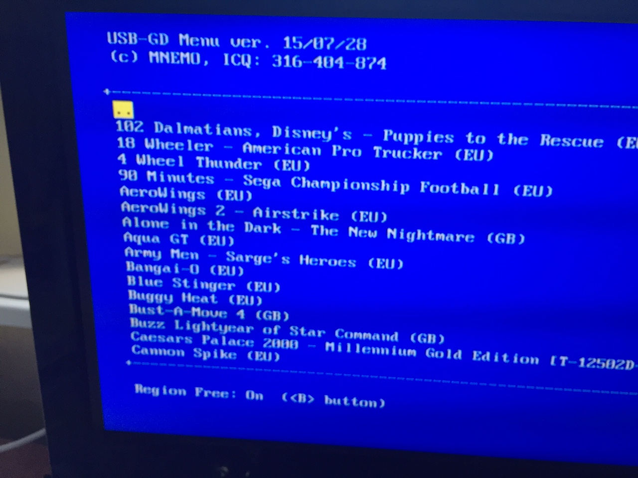

    Oh and by the way. I just picked up a few more USB GDRoms from MNEMO today. They have firmware 15/07/28. No idea whats new in them and its not on his website yet. Must be a beta of some sort =) Still can't switch disks in D2 though.
