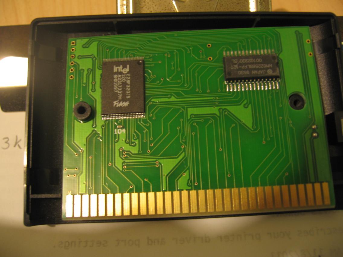

    The newest Genesis/Mega Drive release "Star Odyssey" from Super Fighter Team uses the same type of Intel flash memory that is used in these pirate cartridges.
    The PCB and the rest of the components look to be high quality; it even uses a battery holder instead of a soldered in battery, but I was surprised to find it didn't use a regular ROM chip (or a globtop).

    It's probably second hand - the Intel logo is the old one with the dropped "e" and those J5 parts are not in current production. I am pretty sure they are all non-RoHS compliant, too. This also means that it's unlikely to be fake - they tend to copy new parts.
    The Hitachi RAM chip on the board looks to be second hand, too - it's got a '95 date code and those little SRAMS are not the sort of things that would be lying around NOS for 15 years.
