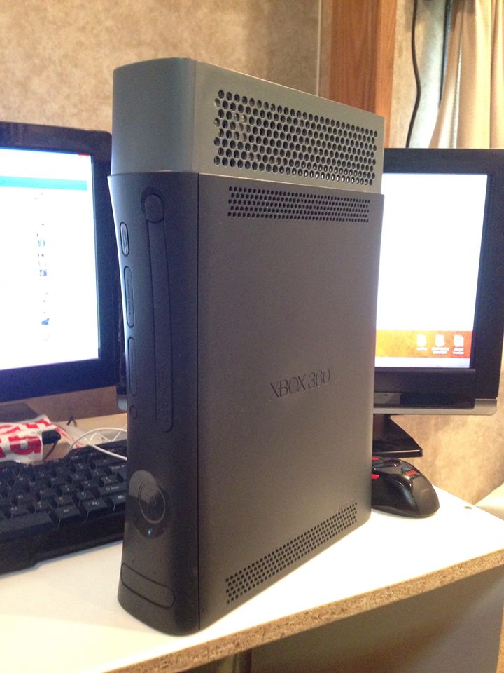

    WOW 80!? dude, i have these dual fans that i soldered together to a board, and they literally just sit behind the console, and work together with the internal fans to add a total of 4 fans on the console, so the external fans are just forcing the hot air the internal fans are pushing out. but these don't use the xbox motherboard power. they use their own power source, they use a laptop charger power so they are like JET ENGINES! lol, no joke. i get 39-40C on both gpu and cpu :)! cold, yes. loud. YES
  20. DeCrYpTiC
    DeCrYpTiC Rising Member
    Jun 16, 2011
    73
    Mind taking a picture of your setup for me?
